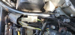

    Hi, I am a new guy posting, but have been lurking for a little bit. A little while back I picked up a 1982 GS450L for very cheap from an acquaintance. The catch was it had no key and ran a bit poorly. I managed to easily hotwire it, so now I just have to get the thing running right! :-D
    This is from memory, and I've never worked on bikes before, so please bear with me. The bike has been sitting for a while during bad weather and for other technical problems.
    I understand these carbs are RPM-based. I can get it to warm up and idle alright (it idled a bit low, but I adjusted the throttle cable to fix the low idle). It runs decent up to roughly 1/3 or 1/2 of the RPM range...then it starts to hesitate hard. It will do it while parked on the stand or while driving under load (which is almost dangerous enough, being bucked off can't be fun!). It will usually, though, kick back in hard at the top of the RPM range and pull strong (once again, going from bucking hard to full throttle near redline is "exhilerating"!). I've tried pulling the plugs after a bucking run, yet they show a nice healthy reddish/brown hue, IMO suggesting properly rich. When bucking on the kickstand, it almost sounds like a lean popping, though. It needs new plugs, i'm sure as well.
    I am used to building up fuel injected/ECU-controlled cars and carbs give me the willies! My guess is a clogged/gummed up jet or the such. I am guessing I will need to tear down, clean, and resync the carbs...... But I will be trying a new fuel filter, cleaning the petcock, and a few other small things before going through that hassle.
