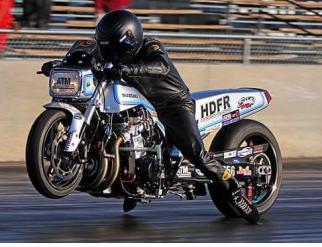

                          This is the quickest GS that I know of 6.65@208 mph
                          but even more impressive in the 1/8 mile
