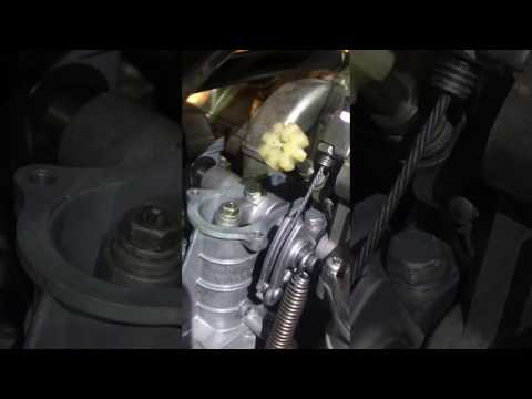

    It is time to choose a more methodical approach. The observant reader may recall my various threads in which I have chased a merry mix of problems with my bike, some related to this problem, some not.
    For reference, this is a video how the idle manifests (Apologies if you have seen this in other threads, embedding it here once again to keep the thread consistent):

                Just a quick update; I've solved the hanging idle, and am now back to a high idle. This is progress; even though it might not sound like it to some ears.
                Real-Life comedy...
                I will write a proper post including answers later on.

                      Alright, so I went to the nearby bike mechanic which already worked once before on my bike and asked for some advice, i.e. second opinion (well, far higher than second ). He confirmed that a high idle is caused by a lean condition (I didn't doubt this), most likely caused by one carb far not in sync with the others. The hanging idle however can only be caused by one or more slides not correctly returning to their idle position.
                      While this echoed what I've been told in here, it left me a bit confused: I did sync the carbs visually already, so how could they be that much out of sync? And I confirmed the throttle cables to move correctly, and with the correct amount of play. And the slide assemblies couldn't just bind up, lest it would block everything from moving...hmmm.
                      Well, nothing else to do than inspecting the top of the slide assemblies, throttle shaft and everything...
                      ..no sooner than when I lifted up #3's hat, that's when I found the root cause of the hanging idle:
                      In case you missed it: the screw fixing the throttle cable carrier (not sure what it's called) to the throttle shaft was loose - this allowed for comparatively huge play. And it's also the reason why blipping the
                      throttle brought the engine back to idle, but going back slowly did not: The throttle return spring is mounted to the cable carrier, so with this screw loose, it's only gravity which pulls the slides back to idle for the last mm or so - and they're comparatively light. That's why slamming them back by blipping did "help".
                      So the case of my hanging idle is closed, thanks y'all for your help.
