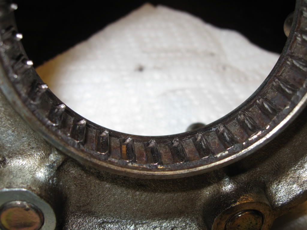

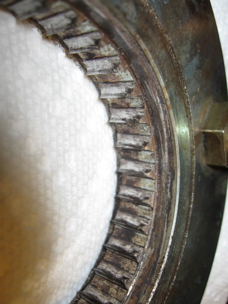

    I'm soon going to be taking my wheels over to bwringer's to get the tires changed. Thanks Brian !! So, tonight I figured I'd pull the wheels off the GK. I already have the fairing and front calipers off so, it was just a matter of taking off a few bolts and axles. Everything went very well until I removed the rear spline......After removing the spline I was giving it a good scrubbing in a bucket of Purple Power....and it got me. The splines are so far gone that they're razor sharp. This is after the bleeding stopped. I think I'm going to live.
    Needless to say, I need a new spline. A little over 31,000 miles, I don't think it's ever been greased.

    Hey Larry!
    I do believe you are the winner. Those are the thinnest splines I've ever seen without being all the way worn off. It's amazing that your rear wheel still turned. Thanks for the pictures.

              Man, that's a close one. You could make a rotory razor out of it.
              • cyclefvr2
                wow that was gone i am suprised it moved at all , you must take care of the bike huh, no spinning the rear wheel?, or is that what its from? lol

                  I gotta say that I think Larry wins the "Thinnest Spline" contest.
                  Probably a good thing the bike was running like poop when we tested it...
                  If you don't have a new one yet, I can hook you up with my "rally spare" for a while.

                    Yeah, the thinnest and the sharpest !! I think another few miles on our test ride and it would've been done. I probably could've got it cheaper if it would've let go during the test ride.

                    The wear comes from mileage and not greasing the spline regularly. It should be inspected and greased at every rear tire change. I don't think this one had ever been touched.
                    Cliff, I already ordered another one. +- $66 delivered. Thanks for the offer.
                    For everyone else...a little heads up....If you're ordering a part that has a superceded part number, search the original part number first.
                    Some of the parts sites have not updated the old part number with the new superceded price.
                    The old number for this spline is 64680-45112, which was listed at +-$47.00. The new part number is 64680-45113, which is listed at +-$114.00. It's the same part, from the same site. It's a little secret, so, just keep it between us....

                              oooo its the soft silver one.
                              I need to make the rounds and stock up on vintage hardened black ones.
                              I wonder what a metalurgical shop would charge to heat treat one?
