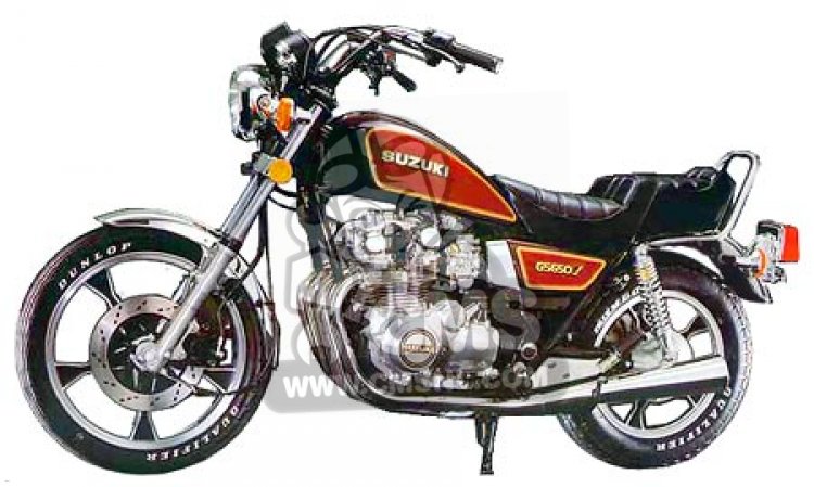

      timebombprod is right. A multiple of tweaks I had one and I never got an entire handle on them all . Suzukiwas bad this way with many models.
      You might want to closely inspect models at cmsnl(link below) ...compare parts numbers,look closely at tank details per decals,paint colours, and even the "country codes" that the parts diagrams apply to. That said, Mostly they cross-over and are the same but you have to be careful . timebomprod's example is the worst I've seen on the gs650, but I've got a 400 here that did the same exact thing .....
      ✓ Suzuki spare parts for GS650 Motorcycle. ✓ Swift delivery ✓ Original Suzuki GS650 parts
