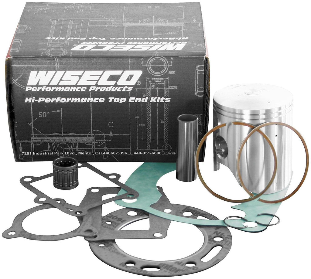

                            I think I found the answer accidently by crawling through (of all places) YouTube.
                            There's a guy on there that built a GS550 caf? racer and used a Wiseco 615cc overbore piston kit made for the Kawasaki 550 of that same era.
                            It makes perfect sense if you think about it because Suzuki & Kawasaki copied off each other like hell back in those days and their engines are damn near identical.
                            Here's the kit that Wiseco makes and I'm almost positive it will work in a late 70's, early 80's GS550
                            Wiseco Performance Top End Rebuild KitPart Number: K615            Piston Size: 61.00mm These kits contain everything you need to complete your rebuild the right way, the first time High Performance ring kit and alloy pin included with each piston kit for extended life and sustained power. Dedicated forgings used for s
