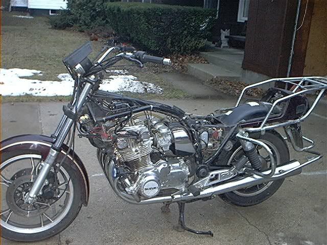

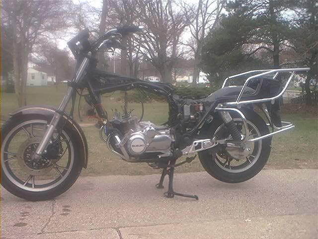

          • 13718
          here is a pic that I found from some long past project on my bike.
          Not the best for this discussion.
          But Can see where the upper rack does go on top shock mount, behind/inside the shock.
          ANd anogther, only slightly better for this conversation....
          On the lower rack, the back part, where it comes up almost to the top rack - that is where it bolts to the lower portion of that trianglar three lobbed part. ANd the upper portion of the trianglular three lobed part, about there, is where the upper rack mounts to that trainglular three lobed part.
          TGHe upper crash bar part of the lower rack mounts on outside of the top schock mount.
          The lower crash bar part of the lower rack mounts there by rear foot peg.
          THe two more obvious screw holes on the round tabs on the upper rack are for the bag mount (bolt thru back of the bag), and look somewhat the same as the two (horizontal) on lower rack (can see better in first pic) for the lower bag mount (bolt thru bottom of bag) (all four with big washers, and rubber mounts, and bushings).
          I have had the lower racks off (when rear wheel off?) at times. I dont think I have had the upper rack off.
          I have not noticed those trianglular three lobed parts before, and didnt know they were removable.
          And (long time ago), I bought what I thought was a complete set of GK side bags, trunk and racks (still sitting in basement). BUt I didnt get those trianglular three lobed pieces.
