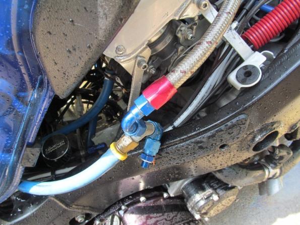

                Today's job, replace a dead fuel pump on the GSX
