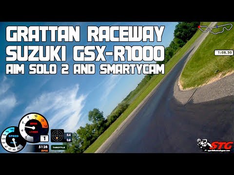

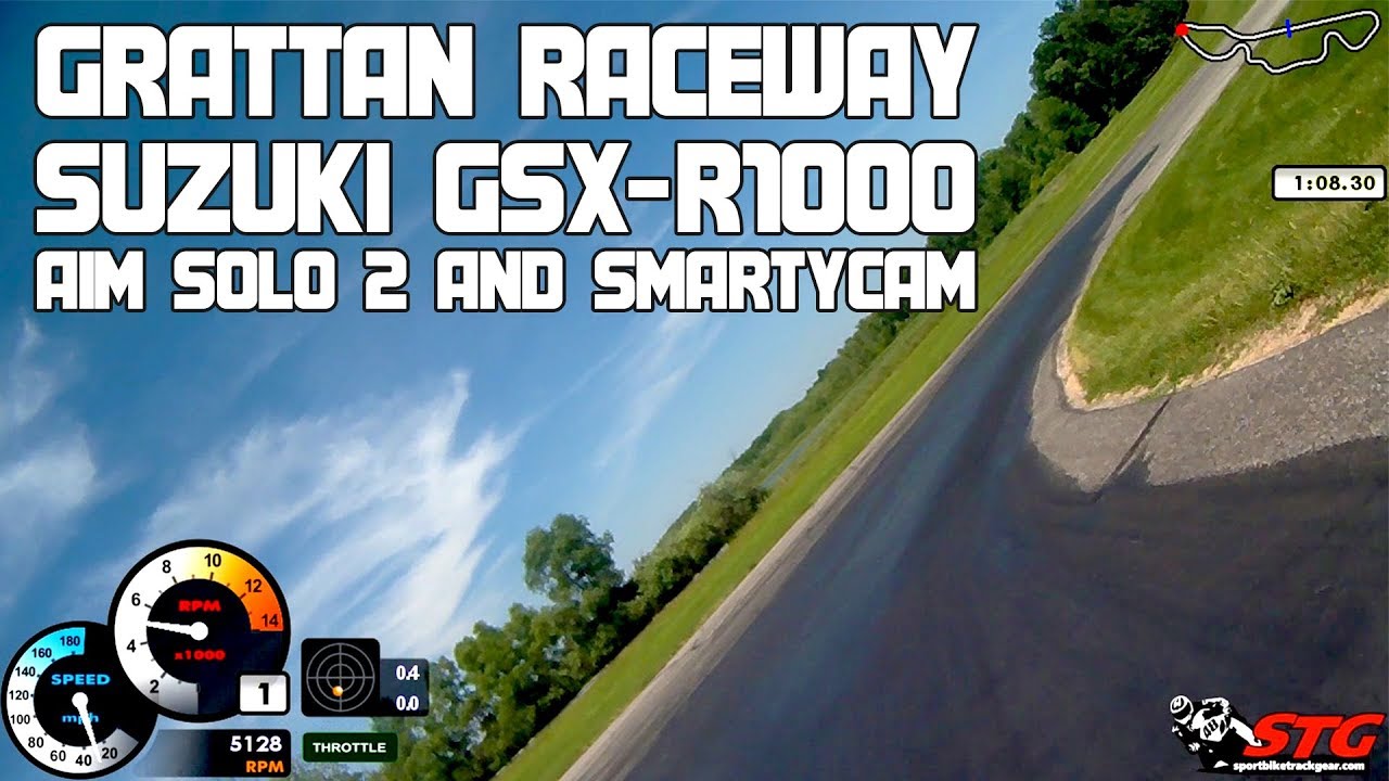

                            I wonder if that would work at Grattan Michigan through the ZZs?
                            See 0:47 through 1:09.
                            I want to do that.
                            Been trying to figure out what the indicator with the bouncing red ball is indicating.
                            • Buffalo Bill
                              • Jun 2008
                              • 6004
                              • New Buffalo, Michigan 49117
                              That's a G Level indicator. Looks like the instant read is too confusing and it's too sensitive, it should be re-set for a longer time span and less sensitive average.
                              Those readouts are for the crew engineers back in the pit.
                              Some coaches want tachs and speedos taped over, because they're distracting. The only place I can take a blink of time look at my tach and speedo is mid straight.
                              This track in Grattan Michigan, is diabolical, designed to X-up riders who think by the book, maybe the most technically demanding track in the Midwest.
                              What this video don't show is how blind the rider's vision is because of the steep up hills. Coming out of some turns I can only see 50 feet of pavement, and have to choose a line based only on memory and experience.
                              Mentioned by many advanced riders as their favorite.
