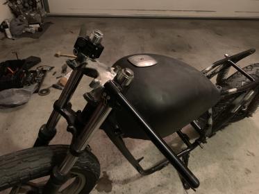

            Guys no worry, a little grinding and it came out pretty good. Still undecided whether to put the bars below or above the triple tree clamp. Let me know your thoughts
            • Nadrol
              If you're going to lower the bike, definitely above the tree.
              Watch out for your trail, you don't want the instability of lowering the front w/o adjusting the rear to suite.
              • RichDesmond
                • Jul 2011
                • 2757
                • NoVa
                There’s also the chance of the front fender slamming into the lower triple. Generally, raising the fork tubes in the triples enough to mount clipons above causes serious problems.
                  • 35927
                  A set of 2.0 springs would take care of that, wouldn't it?
