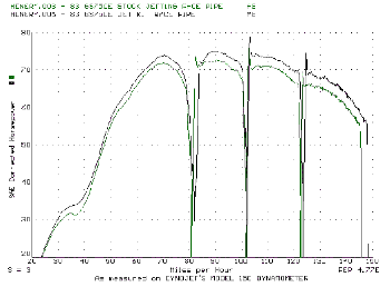

      Well, that's a bit of apples to mangos, as any air-cooled bike these days is not a performance driven design.
      I'm not bashing the GS650 at all, I think it's a great bike. I just don't think that it makes close to 72hp.
      True, though I never considered my GS650G as a performance machine.
      I can't find dyno results for the GS650G, but here they are for the GS750
      Maximum power output: 72 hp/ 8.500 rpm
      But the claimed hp is only 63? https://www.motorcyclespecs.co.za/mo...gs750%2076.htm
