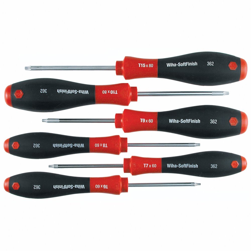

                  I have removed many stuck pilot jets using heat and a mini torx screwdriver.
                  Give the pilot jet a few shots of your favourite penetrating oil then, heat the area around the pilot jet with a map gas torch or propane, take care not to apply too much but you need quite a bit.
                  Tap the torx bit into the top of the pilot jet and undo, (I use a small 4OZ hammer carefully but firmly to set the torx driver.)
                  I'm not sure what size you will need but somewhere around T6, T7 or T8, you don't want to force one in that's too big as it will expand the pilot jet and cause it to bind, the Goldilocks principle.

                    I managed to get 3 of the 4 out with a torx screwdriver and a bit of heat, The last one was a pain and I snapped the torx bit in the jet. I have another set of carbs arriving in the next week or so. I should be able to salvage one of the carb bodies from that and then put the bank back together.

                      I owned a few of the multi drivers with all the various bits, had a few bits break and leave me stranded, so I started buying better quality screw drivers.
                      I have sets from Wiha, Wera and Vessel plus a JIS Impact driver, a bit of $$ to buy up front, a pleasure to use and they have reduced a lot of pain and stress when working on neglected carbs.
