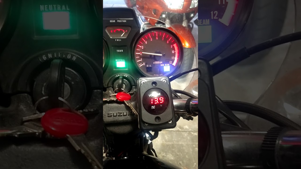

    I didn't film the start efforts -- but here is is 30 seconds after popping to life ...

      I guess the lights are bright but you are not charging with 12.8V at 3KPM

        You get any higher voltage at , say, 4 or 5thous rpm ....?
          Yes - I noticed -- that is why the video stays on that part for so long ---
          I spent a few minutes investigating this weird reading ---
          I don't know why it was like that --
          I suspect a few reasons --
          1) I had the battery tender plugged in to the bike ...
          2) I had spent a few minutes cranking it to get it going (first start since October) and the battery was 'tired'
          Hence the tender plugged in
          3) A loose connection was found at the battery negative (tightened attachment screw)
          This morning I tied again with better results ---
          When it drops to 13.9 I have all the lights on --- Brights and lower driving lights
          14.1 at idle is fine with me
