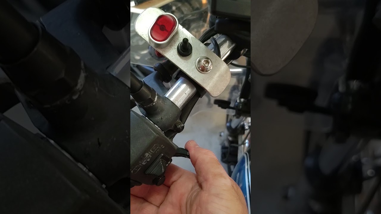

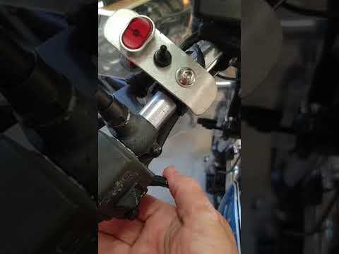

                  • Wingsconsin
                    • 1725
                    • Sussex Wisconsin
                    Hmmm .. what could this be ...
                    • Wingsconsin
                      • 1725
                      • Sussex Wisconsin
                      I did it ....
