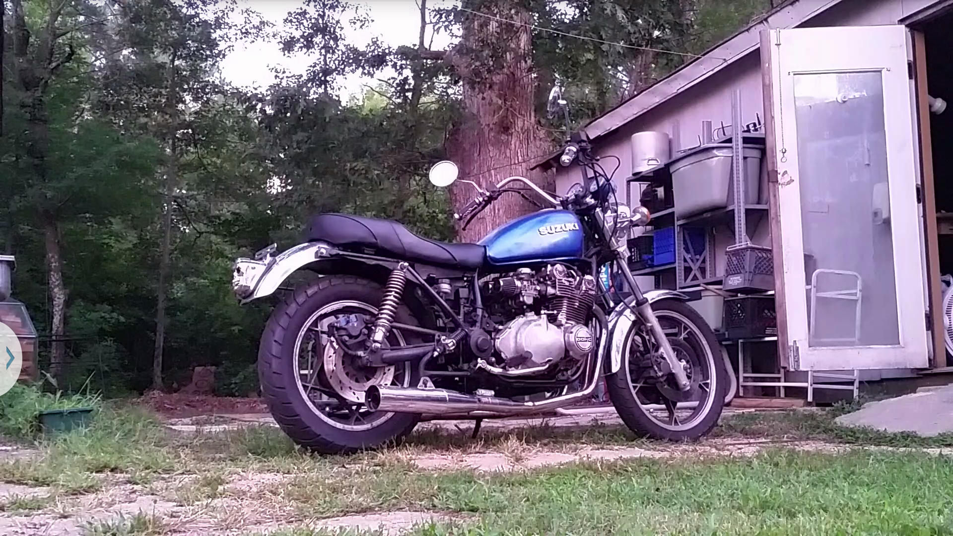

      The carb boots are good. I checked them when I switched engines. My gut is telling me that the main jets are the wrong size. I can't recall what size is in there now, but it just feels like shes really rich in the mid throttle range. One thing I didn't mention is that I'm running pod air filters and the last owner put on an aftermarket exhaust (I'm not sure the make or model of it). I'll post some pics later today when I get off work.

            Yeah, I'm thinking that now. I pulled the carbs off last night and checked the main jets. It had the stock size #115 in it. Just to give it a shot, I had a new set of #110's that I threw in. I test drove it down the street and back and it ran even worse. Still had the low-end, but even less power from 2,500rpm and up. So I know I need bigger main jets.
            For an 850 with pod air filters and an after-market exhaust (Not sure what the exhaust is. See pic.), what size jets would be recommended?
            Note: This pic was taken just after I got the other engine swapped in -- its missing the side covers and turn signals.

              Haven't seen a seat like that on an 850GL, have any other pics of it? It sure is an improvement appearance-wise from the stock seat.
              With pods and aftermarket exhaust, you generally have to do quite a bit of tinkering before it'll run right. I believe the standard advice is to get a Dynojet Stage 3 kit, which should come with a few different sizes. Here's the one for the 850 (no pics, unfortunately): http://www.dynojet.com/pdf/3306.pdf
              Once you have the carbs properly tuned, get some decent handlebars on that thing and it'll be a blast to ride.

                Thanks. I know I've seen a lot of people recommend the Dynojet kit. I didnt know it required that kind of irreversible alterations (drilling out holes), but I guess I'll have to. Hopefully I can grab a kit within the next week or so.
                And most of the pics I have are from when I was working on the bike. I'll have to see if I have any good shots of it. Its been raining for a few days here, so I won't be able to get any new shots soon.

                What's wrong with my handlebars? Lol. I pulled them back a little and I think it sits pretty comfortably now.
