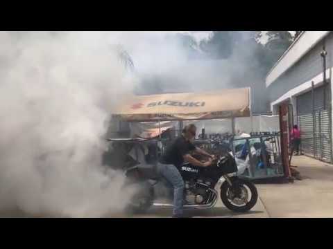

                            Finally all together and ready go (I think) Maiden voyage resulted in a leaky cylinder base gasket. Second resulted in a oil cooler hose comic off and soaking the front nd rear wheel as well as the brakes The guardian angels saved my azz that day. The next ride was uneventful, so I made this video, but it seems the starter clutch bolts have sheared off.
