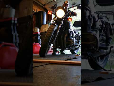

    Bought this a couple years ago. Cleaned up carbs and put on lights. Couple other little things.
    Difficulty putting on airbox!! Won't fit into carbs. Heated and bent them back. Issue is that the box sits at the wrong angle and pulls out on the bottom.
    Which is the correct airbox for this bike?
    Good times. Fired it up today, and it ran for the first time since I bought it.

                          Quick clip of the first start the other day.
