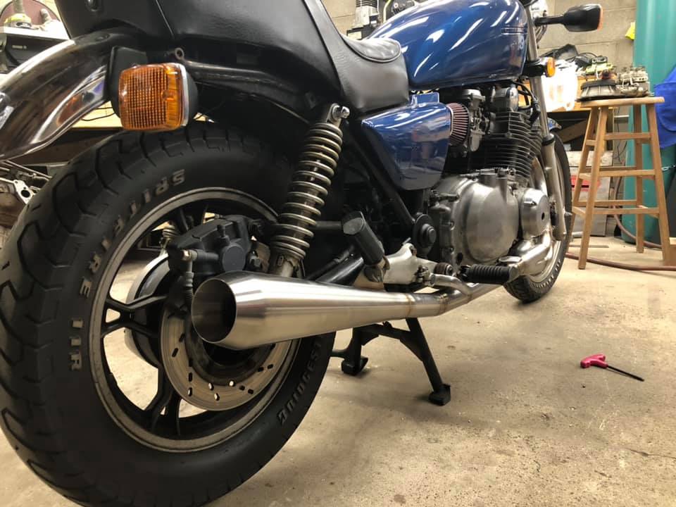

    In the meantime, I decided that I didn't want to reassemble the bike with the ratty looking exhaust, so I decided to build a new stainless steel 4-1 system.

    Here's the GS as it sat when I finished building the exhaust. The engine/trans covers are brushed now, and the emblems have been replaced with new OE.
