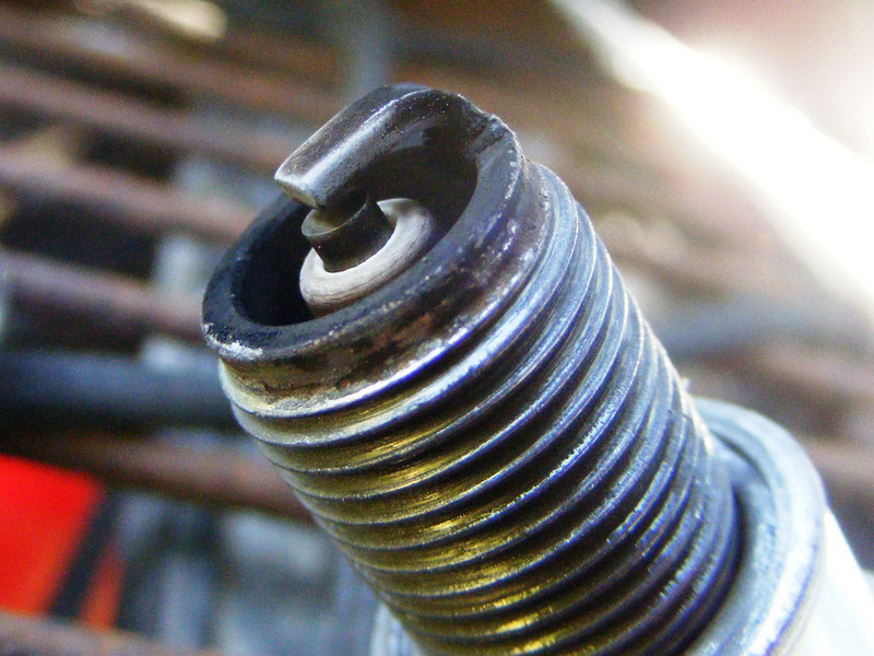

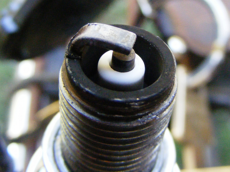

                    • jeff.saunders
                      #430
                      It's good news the bike is running again.
                      If you get a minute take a picture of your spark plugs. Your description is a little concerning.
                      I checked the spark plugs, and they were all black and whitish with no excessive carbon, no caked white stuff, and no oil.
                      They should be a light tan color - white is bad. Given you holed the pistons before, it's worth checking to make sure it doesn't happen again.

                        • shirazdrum
                          #432
                          What's the diagnosis? they looked perfect to me, but I've been wrong many times.
                          • shirazdrum
                            #433
                            No doctors on duty on saturday? Come on people, i gotta go back.
                            • Skateguy50
                              #434
                              You post that in the tech section yet, they are usually pretty quick with opinions over there. I got no good information here... but my guess on the previous engine failure as running lean based on cracked intake boots. You might want to run through the air adjustment screws and make sure its not running to lean based on them.
                              If I recall you start like 2 turns out from seated and adjust them one at a time till it gets the highest idle, and adjust the idle down if needed while testing... but I am no expert.
                                #435
                                Looks really good Chris. Those plugs look perfect to me.
