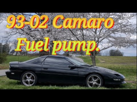

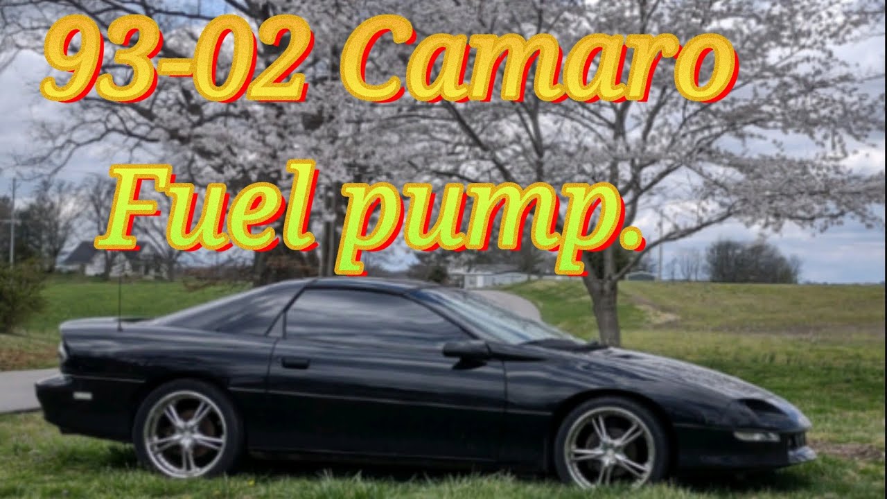

          Just wait Tom, it'll be worse the next time they make a change... Also the wife's 2000 Camaro fuel pump went out. The fuel tank is directly above the rear differential so to replace the pump remove rear exhaust system so you can remove the differential so you can remove the fuel tank so you can replace the $300 fuel pump... I'm still in the days of a $20 fuel pump from Western Auto, 2 bolts and 3 fuel line connectors under the hood, A 1 hr. job for less than $30. I guess those days are gone.

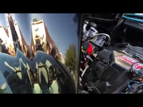

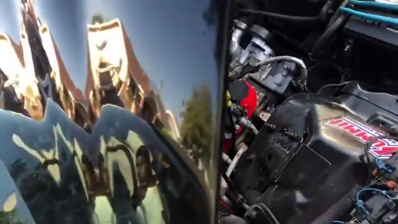

            rphillips, I found a video that may help you. Not sure what language he's speaking. I'm guessing you may understand his dialect better that me.
            This guy got at it from above. Some fancy dremelling involved. If you can follow along w/out getting motion sickness from the slick camera work. I couldn't.
