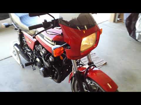

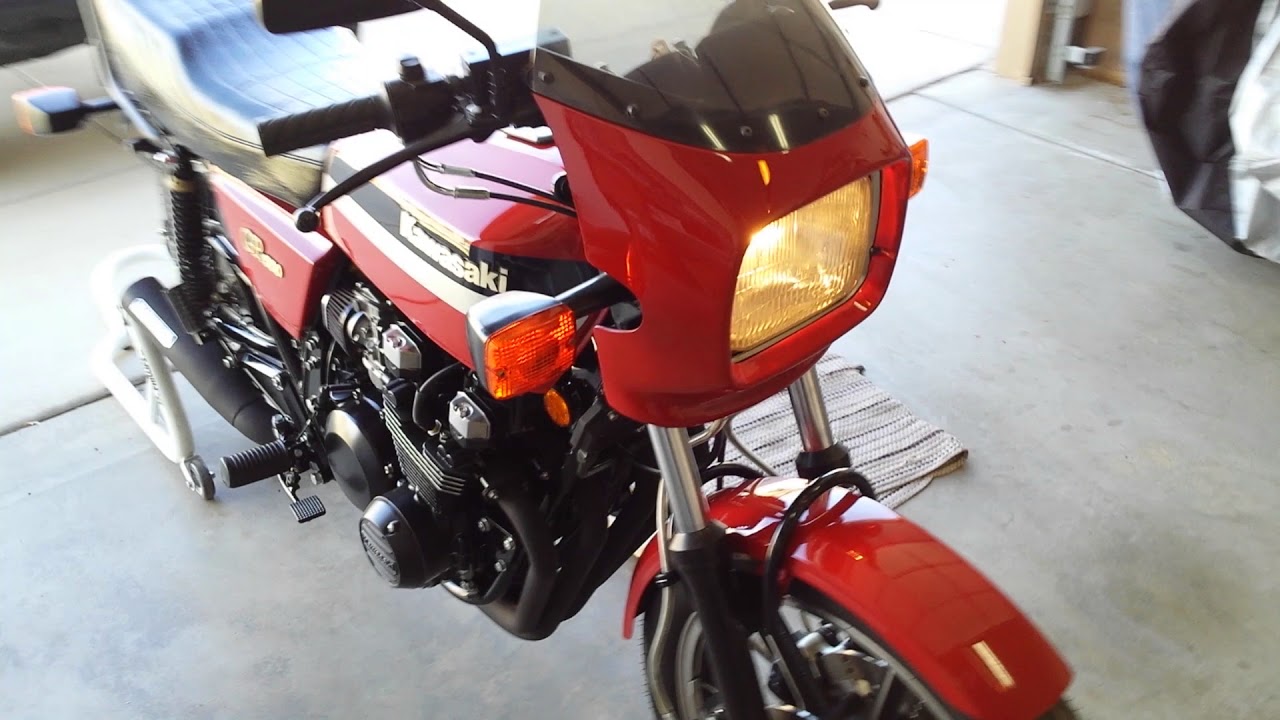

                        Start Up Vid
                        Spent Friday charging & installing the MotoBatt battery, turning the crank over by hand for 15 minutes, adjusting pilot air screws and idle speed, checking the charging voltage, adding oil, tightening valve cover bolts and cutting a relief radius into the inboard side of the chain guard (bowed) to prevent it from contacting the rear wheel.
                        That brings me to 31-Mar-2018, here we go . . .

                          Wow! Must be such a good feeling to hear it run. Superb job on the restoration!
                          • nvr2old
                            • Jan 2009
                            • 2134
                            • Sandpoint, Idaho
                            #448
                            Couldn't be happier for you! It sounds great and looks like it just came off the show room floor. Pat yourself on the back for your perseverance and total dedication to seeing it through to completion. Nicely done.
                            1979 GS1000S,
                              #449
                              Sounds great Steve, just a bit better than the last try! Congrats on a job well done.
                                • 8512
                                #450
                                Fantastic sound!
                                Be rightfully proud of a job well done.
