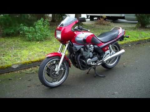

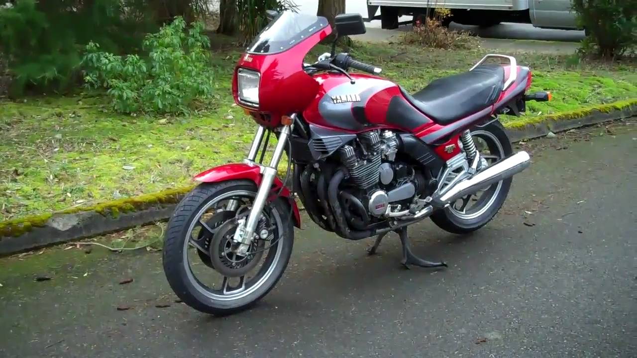

          That was the best iteration of what was here called the Seca, all day comfortable, plenty powerful, and reliable (plus, shaft drive, so good for wet weather). Great looks, too. They did it in a really rich red here that was simply stunning. I passed on a runner two years ago and still wonder whether I should have.
