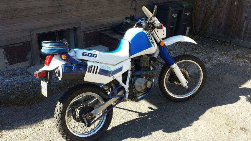

    Well after a short hunt for a bigger enduro I picked up this beauty yesterday. A 1986 Suzuki DR600RG, in very good shape for the year and only 28'000KM on the clock. Should get me a bit further than the old TS250.
  • JEEPRUSTY
    wow that is clean
      It does have a dent in the tank and some wear and tear but over all it's in great shape for a 29 year old enduro. Heck the skid plate still have all the blue paint on it
        Spent the day going over her, gaped the valves and man was that easier than doing the old 8V with shims. Adjusted both the automatic and manual decompression valves and 'I think' I fixed an issue with the manual decompression valve. Cleaned up the chain and adjusted it, and gave her a good cleaning. More routine maintenance to do for sure but a good start today.

                          Thanks Charlie, super happy with it so far. Sounds like you founds a pretty nice bike David and thanks for the reminder about Modern, maybe I'll give them a call this week but really there's nothing on the bike that is missing or broken. But I would like to get a spare set of side covers etc...
                            So far I've done some routine maintenance. Valve clearances adjusted, took me a few tries to get them right , new plugs, oil/filter change, cleaned and re-oiled the air filter. Stripped and dipped the carb and fresh o-rings, new o-ring for the intake boot. Pulled the exhaust system, sandblasted it and hit it with high heat paint. Had to have the local machine shop do some repair to the kick start lever but she's better than new now, and I had them do a repair to a weld on the head light shield. She's running perfectly now as far as I can tell, I'm new to these old Thumpers of course. Next on the list is a new back tire and this winter I'm going to POR-15 the tank.
