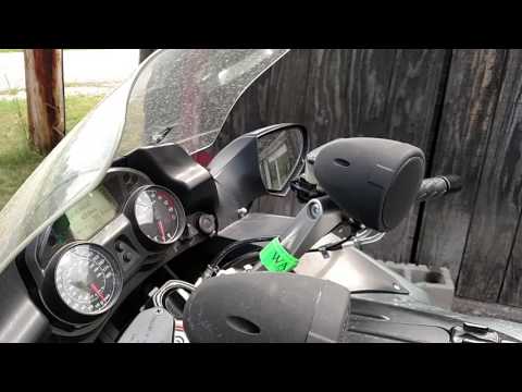

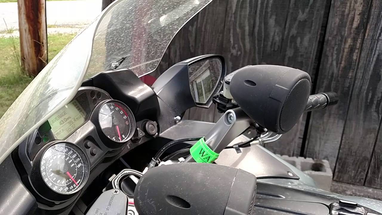

    Recently I added a Blue tooth stereo system to it and we love it. makes those long trips not feel as long and I find it easier to hear my surroundings (sirens and horns) vs wearing ear buds. I either catch praise or grief about adding a stereo, mostly on the looks but hey I/We love it so no regrets. It's a BOSS Blue tooth 4 way system. Cost $130 shipped. It's also fantastic for camping for you don't have to rummage for speakers, just turn the ignition on and listen to tunes for hours.

      It's a Boss MCBK470B
      It's Bluetooth and I also installed an AUX line into my glove box so we can use my girlfriend's iPod when needed.
      The idea came to us when we went for a ride on my Brother's brand new Road Glide. The stereo was a great idea and we thought we should have one for our bike too... So I looked around for the best reviews of motorcycle stereos and this one had one of the better ones. For the price of $130 shipped it was well worth the investment. Now we have a nice sounding stereo ready for Camping and Rally trips.
      It's loud not sure obnoxious but my buddy told me he heard the bike before the stereo when I was coming down the road... One of those accessories I never thought I would buy and love. Also it's extremely helpful if you have your GPS on and listening out for turn by turn directions!
