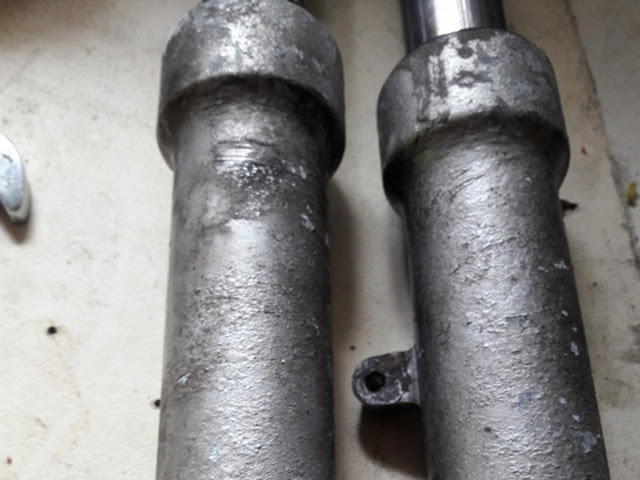

      Those horrible forks were next on the list to sort out, they made me shudder every time I looked at them.
      A few hours later and lots of sanding, buffing and polishing and they were looking good once more, probably better than when they left China.
