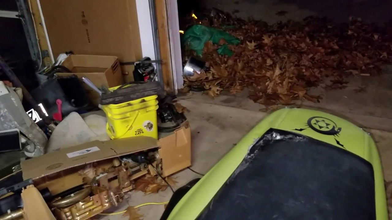

                Got tired of the tear in my passenger seat getting hung up on my back pack.
                Did a half-arsed repair.
                The adjuster on top of my fork looks to be ground down from a crash/ sliding down the road up-side down. I can only assume the pass seat got messed up the same way.
                Some clamps and steel tube with a heat gun to put a crease in to hide my horrible stitching.
                Complete-ish. I need much shorter staples. I'll pull these out and fix it later. Maybe...
