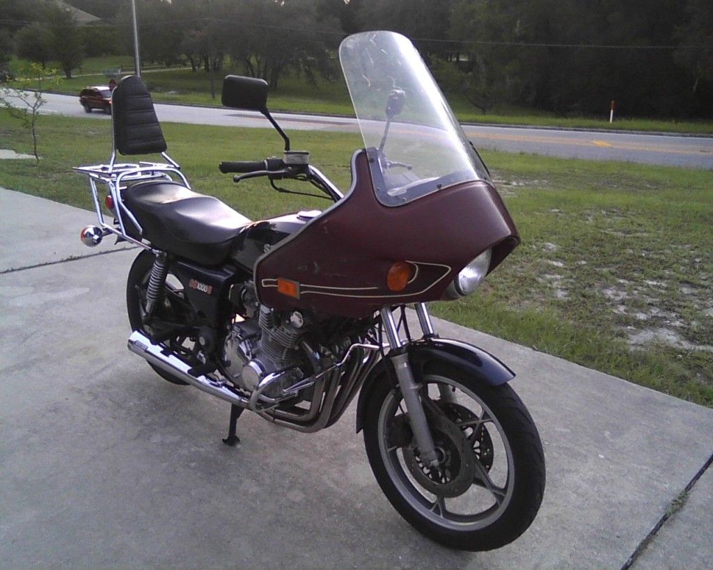

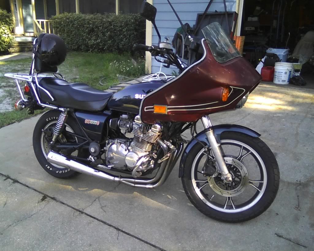

          I've cut two windshields. The one on 1000G Fuller fairing and the one on my Cavalcade. I used a cutoff wheel both times and had great results. yeah it melted the plastic, but that snaps off easily and leaves no damage as the masking tape like Ron suggested protects the surrounding areas. I cut it in two passes. First to establish the cut and the second to cut the rest of the way through. I then block sand the edge with 400 grit on a padded block and then 800 grit to smooth and round the edge. Also, I cut both while they were still mounted on the bike.
