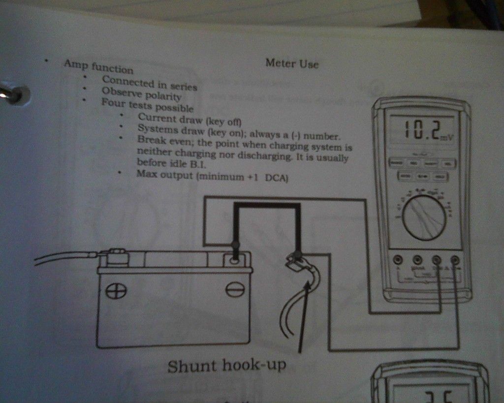

        This is the MM I am using.
          Should I be switching the positive test to the milliamp hole? I broke out my notes from MMI and It looks like current draw is done with the leads in the normal voltage locations, but this is with using a shunt cable.

              OK, well, first, the meter in the diagram is connected incorrectly. The display shows mV, and the leads are connected to the voltage/resistance jacks. The two lefthand jacks are for measuring current -- the far left is for larger current flows (Amps), and the next one is for much smaller current flows such as what you're trying to find, mA-level or less. Your function dial probably has a position that matches the lead socket, i.e. Amps, & mA or uA. (The black lead remains plugged into the COM socket).
              When in doubt, always start with the larger setting (far left). If it's small enough, you can switch over to the low current setting for a more accurate reading.
              I have no idea what the dark path on the circuit diagram is supposed to be; everything else is correct, i.e. putting the meter in series with the load to measure 'parasitic' (maintenance) current draw.
              IMO, whoever got paid to draw that diagram should be slapped twice. This can be confusing enough for beginners without glaring errors in the manual.
                Yes, you should. Also select the mA position on the function dial.
                You can ignore the shunt diagram they show you; it's for measuring really large current flows. It's correct in that you'd have to disconnect a battery terminal and put the meter in series with the load.

                  Yeah I thought of that sleeping last night. I broke out my notes to see if I was correct in switching the the leads, but that was the only reference I can find for current draw. I have been using mA selection, but I wasn't switching the test leads. I may have been chasing a ghost for nothing, but then what is drawing the battery down if the R/R is producing enough voltage, but not fact. spec. charging voltage, when running?
                    That thick black line in the diagram, represents an 18" long battery cable. That's the only reference I could find for current draw.
