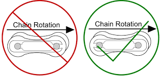

            I have heard of failure from Rocks just perfectly hitting the link and knocking the circlip off. I always install the clip so that the open end points to the rear of the bike if its on the bottom of the loop...or faci ng the front of the bike if its on the top. However one chooses to view what I mean.
              I didn't want to get in or this tit for tat over chains, but your putting the clip on wrong. The open end should be pointing towards the rear sprocket when on the top of the chain run, not the bottom.

                I was taught the other way around. Reasoning was that the chain was inside the guard at the top and exposed at the bottom. If road debris happened to come up and hit the clip it would be hitting it ONTO the pin and not off of it. Less chance of a clip knock off that way.
                  The interweb never lies.
                  A motorcycle chain Master Link has an open and and a closed end on the retaining plate, and you always want the closed end of the Master Link retaining plate to be facing the front of the bike when the chain is on the top of the swingarm.Feb 11, 2017

                    Im staying with the way ive done it forever. Maybe thats why i havent had one knock off yet??? Does this Jeremy guy think it has something to do with it falling off due to stretch or somthng??

                      As the chain is rotating on the underside of it's path it is practically staying still with the passing ground as it is moving in the same direction. The real speed where it would make a difference would be on the top side where it is moving forward and objects are passing by, like rocks and branches while riding a dirt bike which have no guards.
