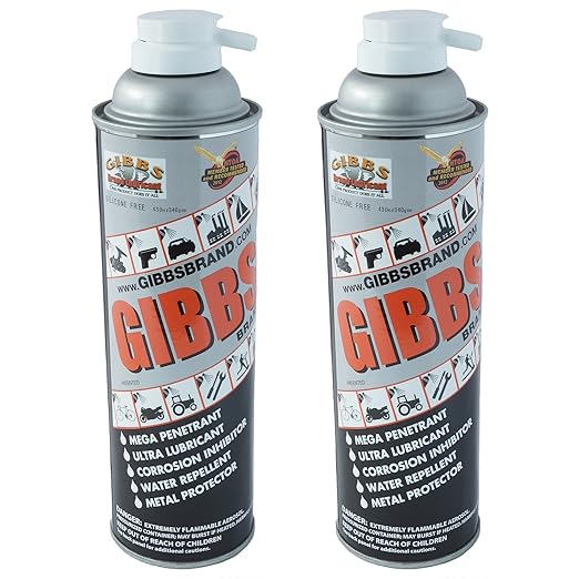

                    I have a 3L Stainless Unit, (should have got the 6L size.)
                    I use distilled water and Franks Special Cleaner, about 125 mil per tank and run it at 50C (120F)
                    After 45 minutes or so I take them out and rinse in very hot water, blow them out with air and then spray with Gibbs Lubricant.
                    The carbs do not darken and usually come up very nicely.
                    2018 Honda Africa Twin AS
                      • 8512
                      Never heard of Gibbs Lubricant.
                      Pricey, but Amazon reviews certainly say it is a great product. Looks to be $25.00 or so on Ebay.
                      • Kiwi Canuck
                        • 1750
                        • Langley, BC
                        https://www.amazon.ca/Gibbs-Brand-Lu.../dp/B00AFJXIJQ
                        Steve, I bought a case of 12 about two years ago, worked out to be about $16 CAD per can IIRC, a bit pricey but a little goes a long way.
                        Love the stuff, it's so universal, I even use it on my cereal when I run out of milk.
                        David.
