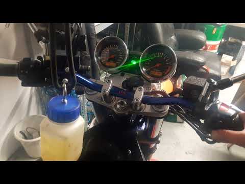

              It may not be enough to matter, but for fuel to get to the oil, there has got to be both a leaking pet cock & a needle & seat leaking a little. I wish my handlebars were as tall as yours, mine are both shorter & narrower, but the wires & hoses won't let me raise them near that much & I won't let myself pay the $$$ for the Holeshot kit. What is the little blinking light on the triple clamp nut, I saw it when you turned the key on. Just for info, I bought a digital, electronic gear position indicator from Holeshot, that I love, reminds me of the old Suzuki's that came from the factory with them. Sounds good, congrats.
                The petcock was set to ON for the last 4 years while it sat.
                When i took off the hose from the petcock, gas kept trickling out.
                The needles/seats were very, very dirty. (check post #41)
                The gas tank still had over 18 liters of gas in it, so not that much could have leaked.
                That's part of the Spyball alarm system.
                My GT750's have the gear indicator too, love it.
                Eyeballing that indicator too.
