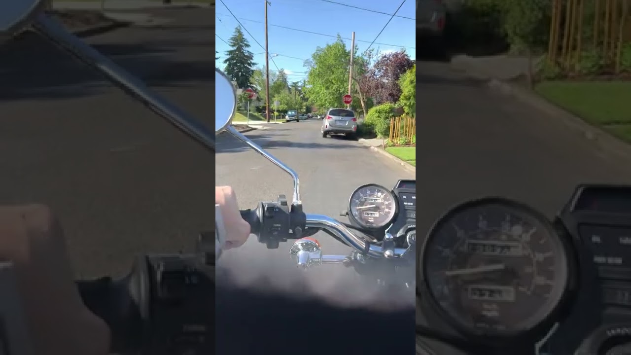

    I'm pretty sure I was hearing this gear whine last summer, but after taking the bike out after winter storage it's sounding quite loud. It's speed dependent, pulling the clutch does not really change it. Link to the video basically shows it all.
    Is a noise like this indicative of a particular type of failure? Any advice on how to proceed greatly appreciated!

          Thanks all for responses! I spun the speedo cable with my drill in reverse from the wheel end. Confirmed same noise, so I'll pull it and investigate/lube as suggested.
          Very glad I asked. My thoughts went straight to issues in the engine case, hopefully this should be significantly easier. Sound was not at all clear in a helmet with engine noise mixed in. Now I know!
            Hey all! Embarrassed to say it took this long (10 months!) but I finally pulled the speedo and lubed the inlet with some air tool oil. Did the tach as well. All quiet now. Many thanks!
