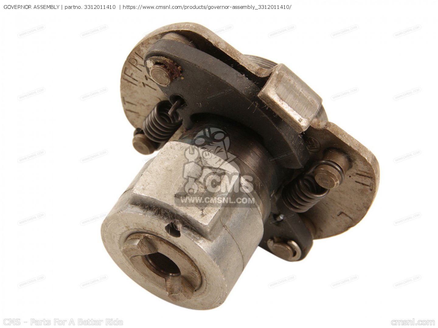

                ✓ Good to order: GOVERNOR ASSEMBLY ✓ Manufacturer Part Number: 33120-11410 ✓ OEM Suzuki part
                ✓ Get the GOVERNOR ASSEMBLY ✓ Manufacturer Part Number: 33120-44120 ✓ OEM Suzuki part
                Same numbers for a 250 and 400.
                450 has a smaller cap but the advancer part is the same by the looks of it.
                That doesn't matter because the dyna comes with a rotor cap that you put on the advancer. So you could even use a 450's advancer and throw away the rotor cap.
