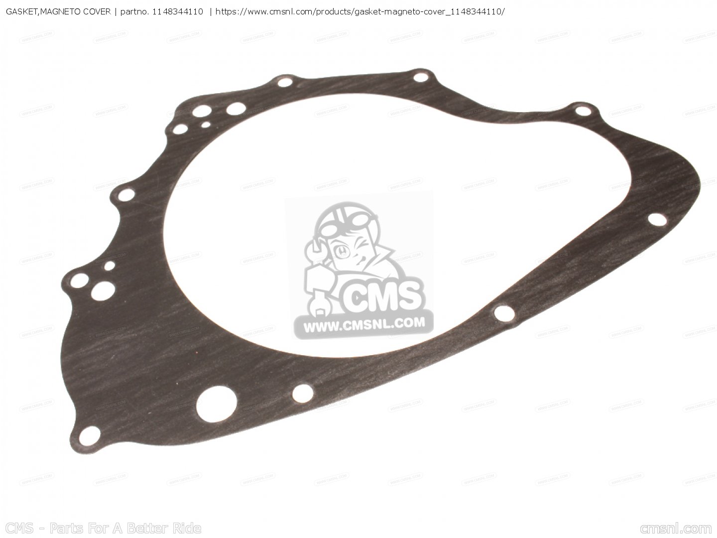

      Best bet is to buy a genuine suzuki gasket though its much better than anything that can be made IMO.
      here is the part number :11483-44110
      ✓ In stock now GASKET,MAGNETO COVER (NAS) ✓ Manufacturer Part Number: 11483-44110 ✓ Genuine Suzuki part
