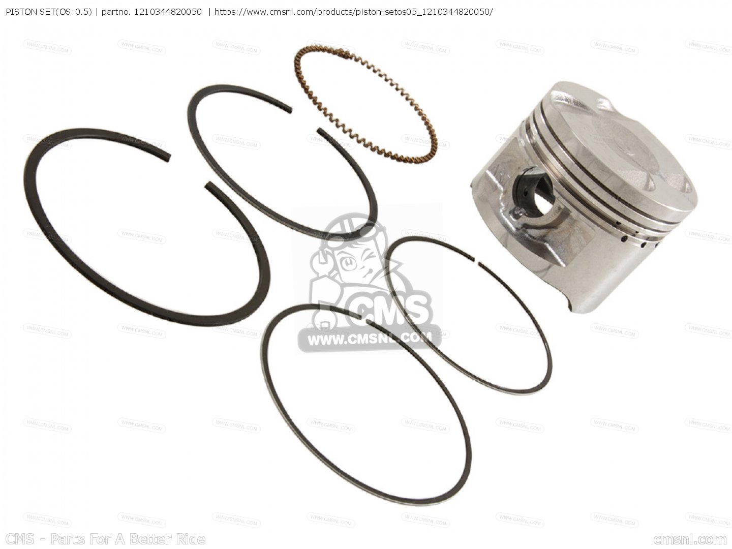

                I have used a company called CMSNL for parts. They are expensive but their website is great for finding part numbers. I think this may be what you are looking for
                ✓ Get the PISTON SET(OS:0.5) ✓ Manufacturercode: 12103-44820-050 ✓ Genuine Suzuki part
                  http://www.cmsnl.com/products/piston.../#.VcDSQ_NVhHw
