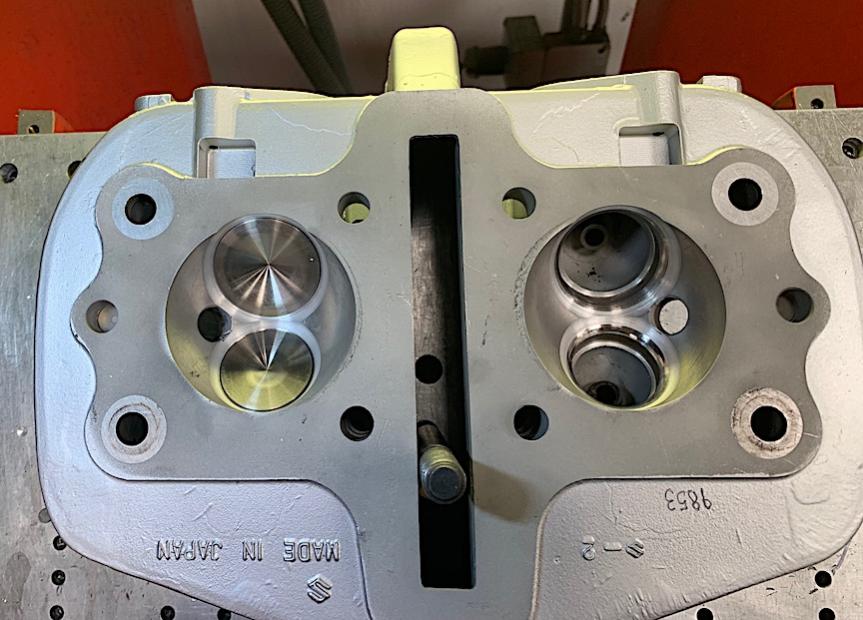

    GS400 / 425 head machined for oversize valves 38 / 32. Ready for the porting department for blending. These heads really respond to this mod as, stock, there is quite a restriction where the port meets the seat.

    Do go on with story, but please include before pic and specs.
    Like to know how to do this to the GS650 and GS1000 heads.

      Kibblewhite has a 25mm and 30mm over size setup for a GS1000.
      Just grind the seat for the over sized valves.
        As you can see from the photos, the seat throat has to be opened for the oversize valves. You can't just cut the seat larger for the big valve. Then care must be taken to keep sufeciant valve to valve clearance so they won'y hit other when it is running.

          Yes, I have pics from the valve job I did on my 1100G last winter. Looks like no room for larger valves in that head.

            Now we're talking! MORE INFO, PLEASE!
            I have a few 425 heads and I think a complete 400 engine and maybe a 2nd 400 engine for parts awaiting me.
            I've been wanting to build a hot rodded GS425 big bore for some time now.
            I was contemplating oversized valves, but figured maybe a street porting job was the furthest level that it was reasonable to take it to...
            Now you've got me convinced otherwise.
            449cc with Wiseco K844 GS750 pistons, aftermarket cam grind with higher lift around .420", and some CR33 GS500 carbs or some RS34's modified into a 2 cylinder rack... that's what I'm talking about!
            I actually have a pair of NOS slightly used 920cc GS750/850 pistons from MTC Engineering to make a 489cc GS425 with 850 sleeves or perhaps 450 sleeves machined into the 425 cylinder block...
            I really want an old school roller crank GS twin stripped down and hot rodded out, a lighter weight very flickable, braced-frame, upgraded wheels/tires/brakes/suspension, kinda twisties machine... possible WERA Formula 500 racer as well as Vintage 3 or Vintage 4 or whatever class I could competitively fit it into... AHRMA would limit it to 449cc iirc? WERA would allow a GS400-425-450 up to 550cc, but that's insane on a 400/425 cylinder stud spacing, only do-able on a very hogged out 450 with 500 cylinder jugs and a base gasket spacer.
              Is this a customer's bike you are working on?
              Is it a vintage race bike?
              Or just a hot rod?
              Thanks for the additional inspiration/motivation, Big Jay!
