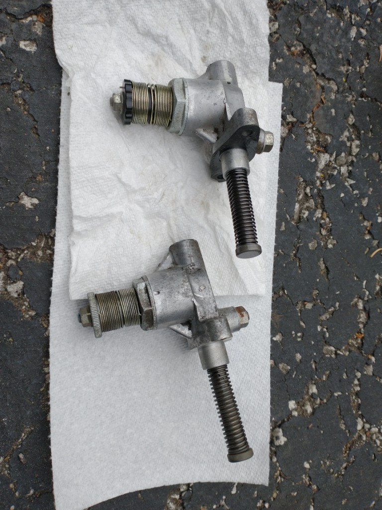

Hopefully this is the last update on the matter. I replaced the tensioner with a decent looking one from eBay. Immediately I could tell the knob had more spring tension than mine. I'm guessing I missed a turn of tension when replacing the oil seal, which didn't give the tensioner enough resistance to hold the cam chain in place.
I've ridden the bike almost 300 miles with the new tensioner and it seems to be holding. So hopefully it is all good to go now!
The replacement is on the bottom, compare the tightness in the springs.
