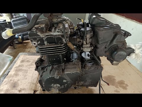

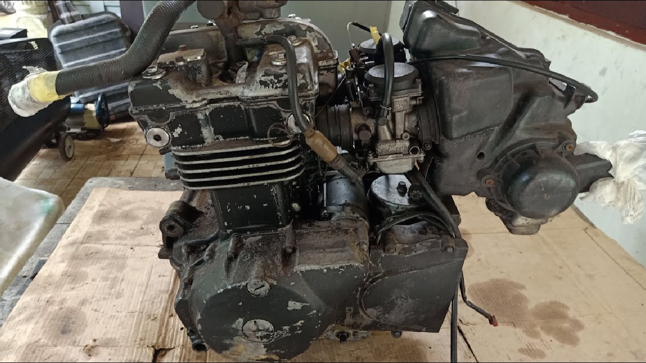

      I'd be looking at the parts diagram awfully closely.
      meanwhile here's an entertaining video..
      Kawasaki ER5 engine Full Restoration | Kawasaki ER5, KLE, EX500 Engine Restoration in18 minutes
      it's a slightly more complicated engine so you should be able to do it in 14.
