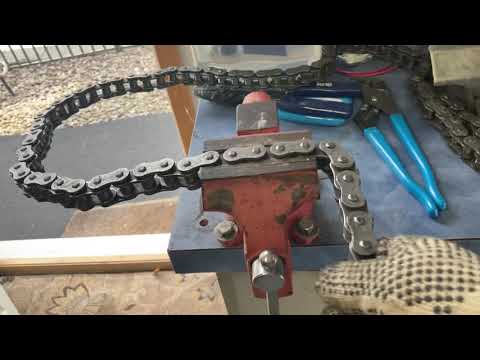

        Bandito, I've linked the chain thread I created. My guess is if you took your your chain off you'll probably find it's roughly in the same condition as mine in this video that's in post # 22 of the thread.
        Think about a 530 conversion. It wasn't the easiest thing I've ever done, But the help I got here gave me the courage I needed.
