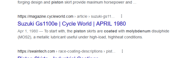

    But I realized today during parts cleanup and inspection that these pistons were coated from the factory. The coating is uniformly gone from all the pistons except in the wristpin region. Otherwise they look pristine.
    Can anybody tell me if this is a problem for these motors? The coating seemingly very thin, thinner than the armorglide on the latest wiseco (and other) pistons.

    The stock pistons were not coated. Can you post up some photos?
    You might want to measure out of round, taper, and piston to wall clearance. No more than .0010" out of round or taper allowed. Piston to wall clearance is less important; the manual states that .0047" is the service limit. As long as the specs fall inside these numbers, I'd run the engine, regardless of piston coating.
      thank you for the reply, and see the attached. the gentleman who sold me the GS750 gears and oil cooler mentioned this in passing as we discussed other aspects of my build. but he recalled that it was on later models only..
      I will take some measurements this afternoon. but the original finish on the piston is still discernable.

        I stand corrected. Here are some stock 1100 pistons that are coated...https://www.ebay.com/itm/393419200174
        I think the coating is largely for break-in. I still say if the pistons and cylinder measure in spec, I'd run them.
          Thank you. Some improved measuring tools en route, but my inside micrometer tells me the bores are round and well within spec, Ring gauge to verify its accuracy coming, and the pistons will be double checked when the 2-3 micrometer arrives. And ring groove widths are spot on.
          It was also suggested that a feeler gauge can also be used with a naked piston inserted in the bore. A new one on me, will explore that tomorrow...

            I agree with Nessism​ about the coatings being for break in. With only 10K miles on it, unless he ran it out of oil, I wouldn't think the bottom end would even be an issue. Best of luck and many miles.
