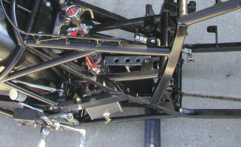

          Here's a photo of one of my GSs. The catch can sits in the lowest part of the belly pan. The filter is much higher up. That tank holds about a pint. It has a valve that allows me to drain it easily. Vent tube routes up from the top of the motor.
            My back halved GS. You can see the vent filter on the far lower left is again located higher than the catch can (center bottom). It's also far to the right of the tire. I designed the tanks with internal baffles the minimize the chance of oil getting to the filter. Also note the tank's easy access drain valve. A pop bottle with paper towel and a zip tie would work just as well and be lighter.
              I have seen a beer can used more times than you can shake a stick at.
