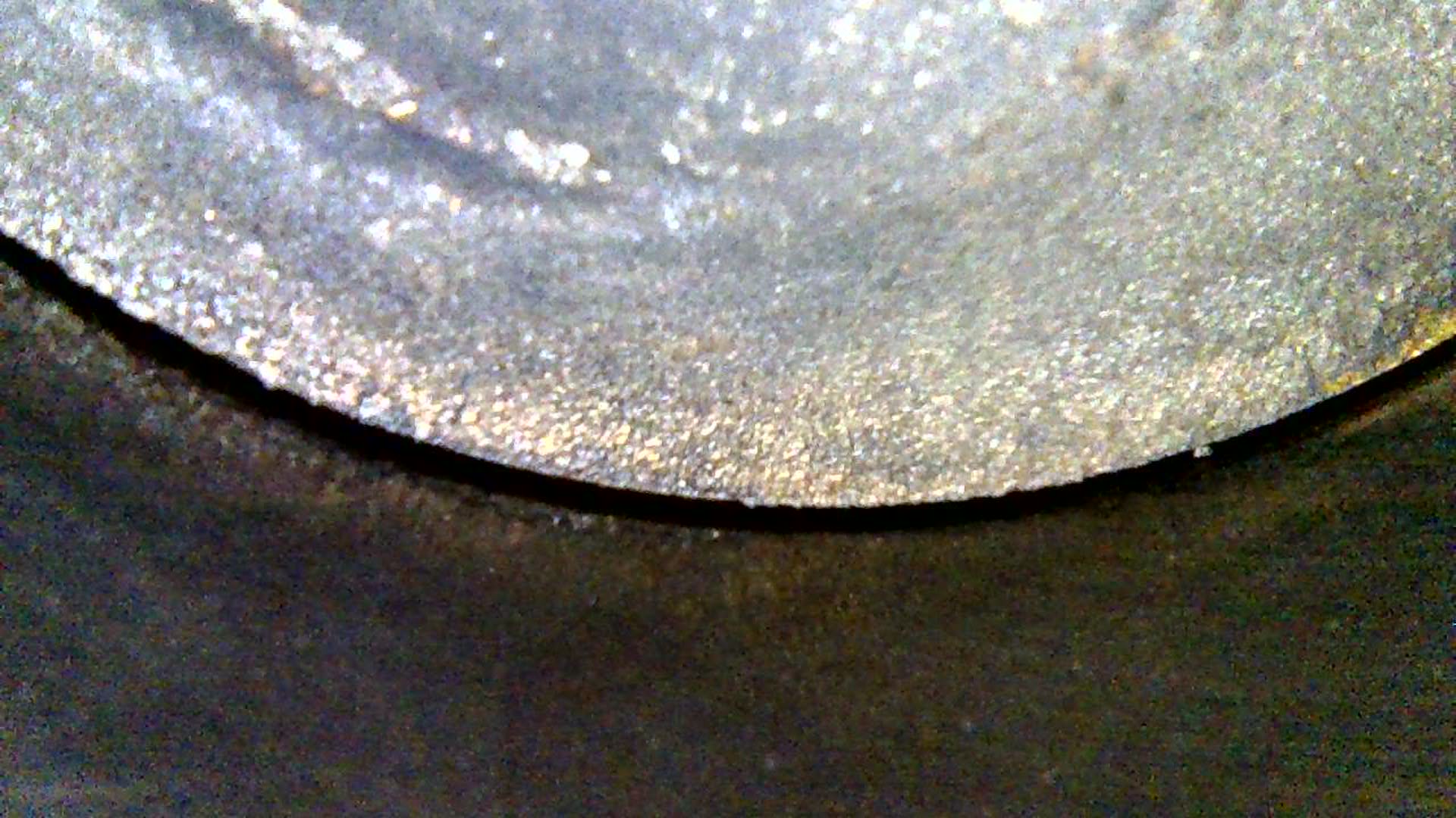

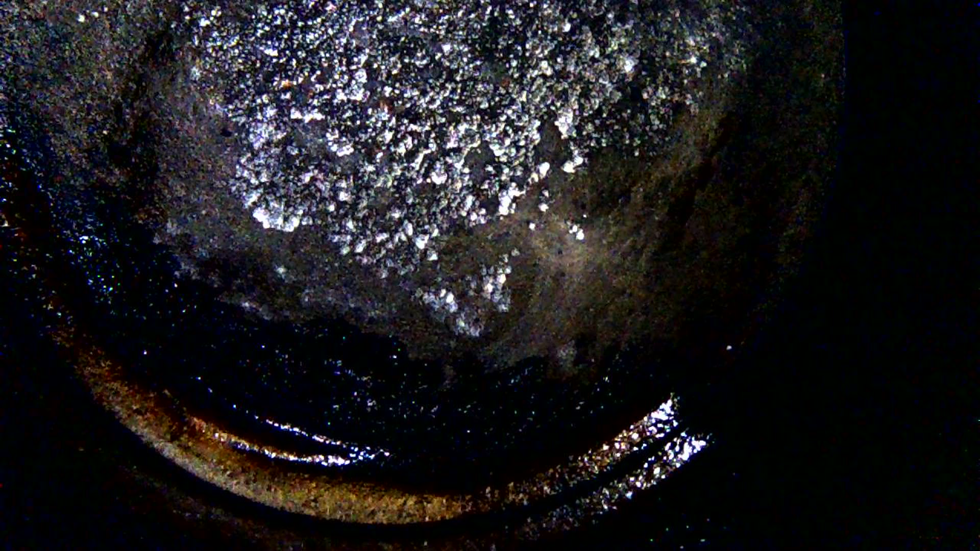

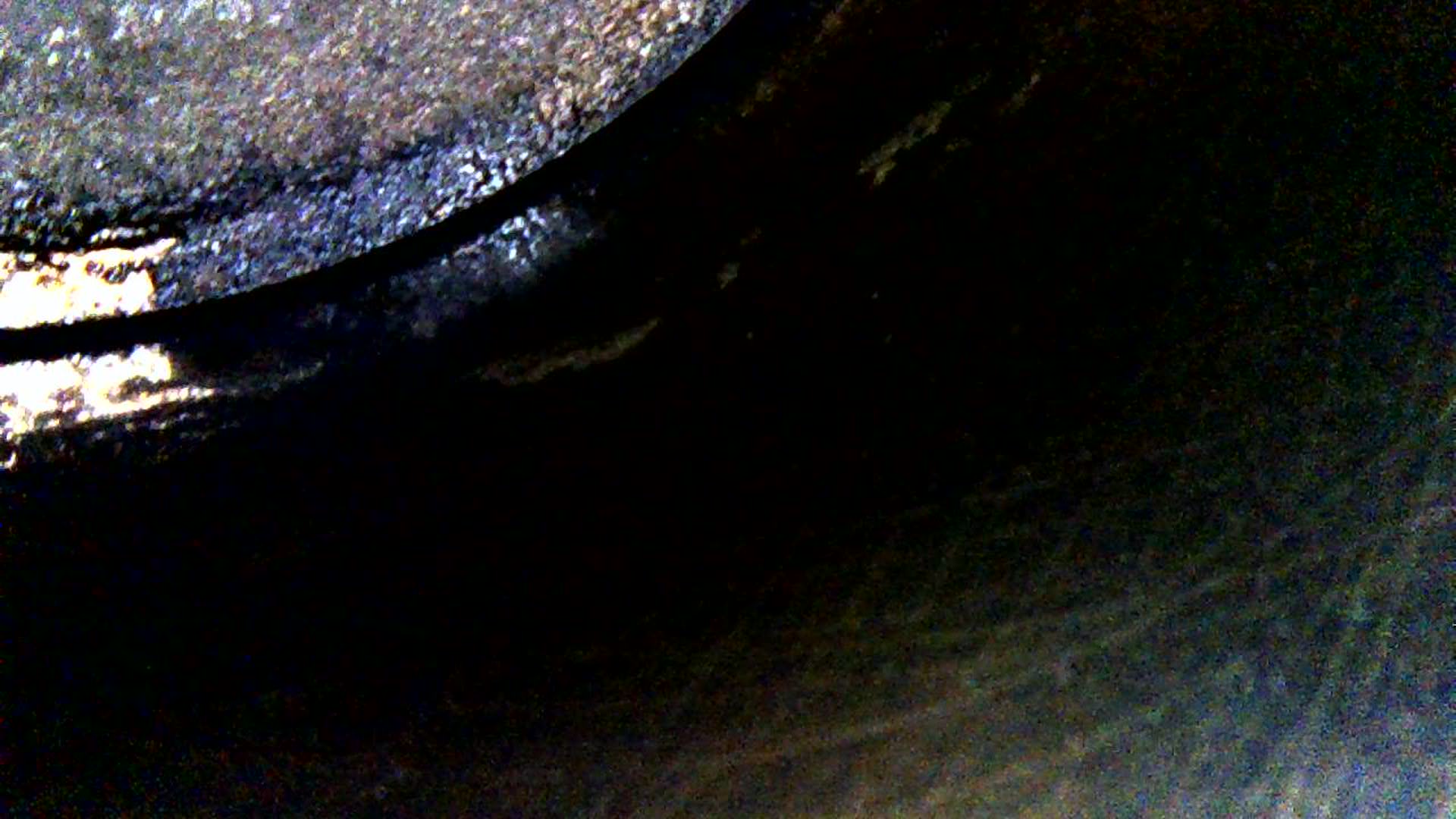

    Cylinder 1 - the major suspect.
    I see a lot of burnt oil (the shiny stuff on the bottom lip and piston head, right?)
    a LOT of burnt oil - but it seems there's a little bit on the piston head (from the rings) and a lot under the intake valve (bottom of these sets of image) - or is it the other way around, and the valve leaks on the head while the rings lean around the edge?
    ​I also think I see some ridging (damage around the radial direction) and possibly scoring (damage up and down the cylinder) in this image (right hand side). It's hard to tell because the crosshatch lines catch the light differently at slightly different angles - but there seem to be a lot more lines going straight around the cylinder here than on other cylinders.

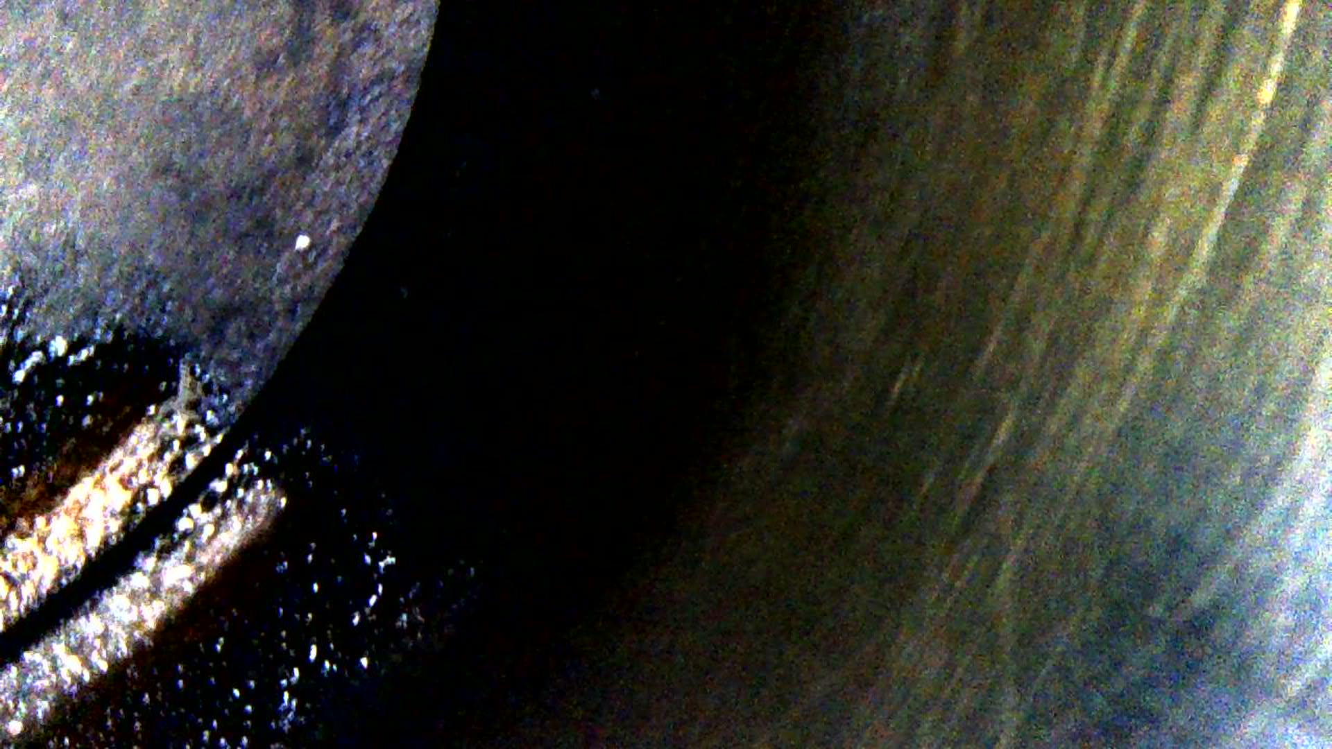

    Cylinder 2 - looking good enough, I think
    Cylinders 2 and 3 have cylinder walls that look a lot like this. This seems to be pretty clear cross-hatching to me, which is a good sign.​ EDIT: now I'm seeing a horizontal line in this image...
    However, you can still see there's some burnt oil. Old rings, or about what you'd expect from a 44 year old engine?

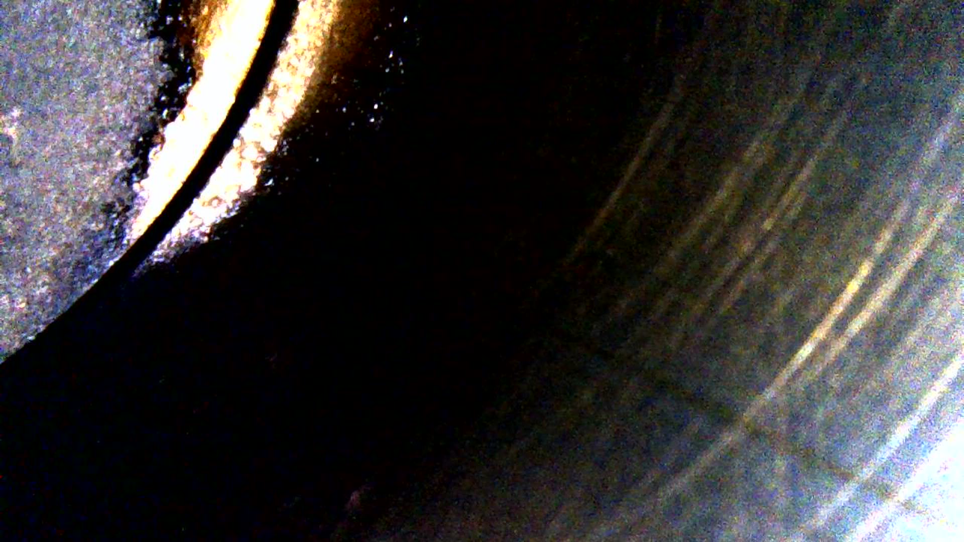

    Cylinder 3 - even cleaner
    Cylinder 3 has the same pattern as in 2 on the walls. It also has a significantly cleaner piston head - don't believe I saw any evidence of burning oil in there.

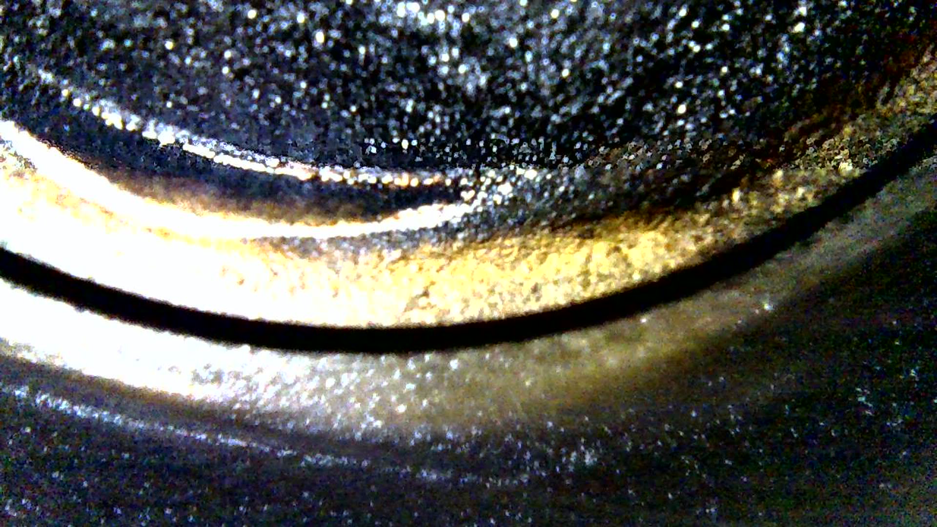

    Cylinder 4 - kinda nasty
    Cylinder 4 also has some burnt oil - not as much as 1, but a little more than 2. This picture also appears to show a vertical score to me.

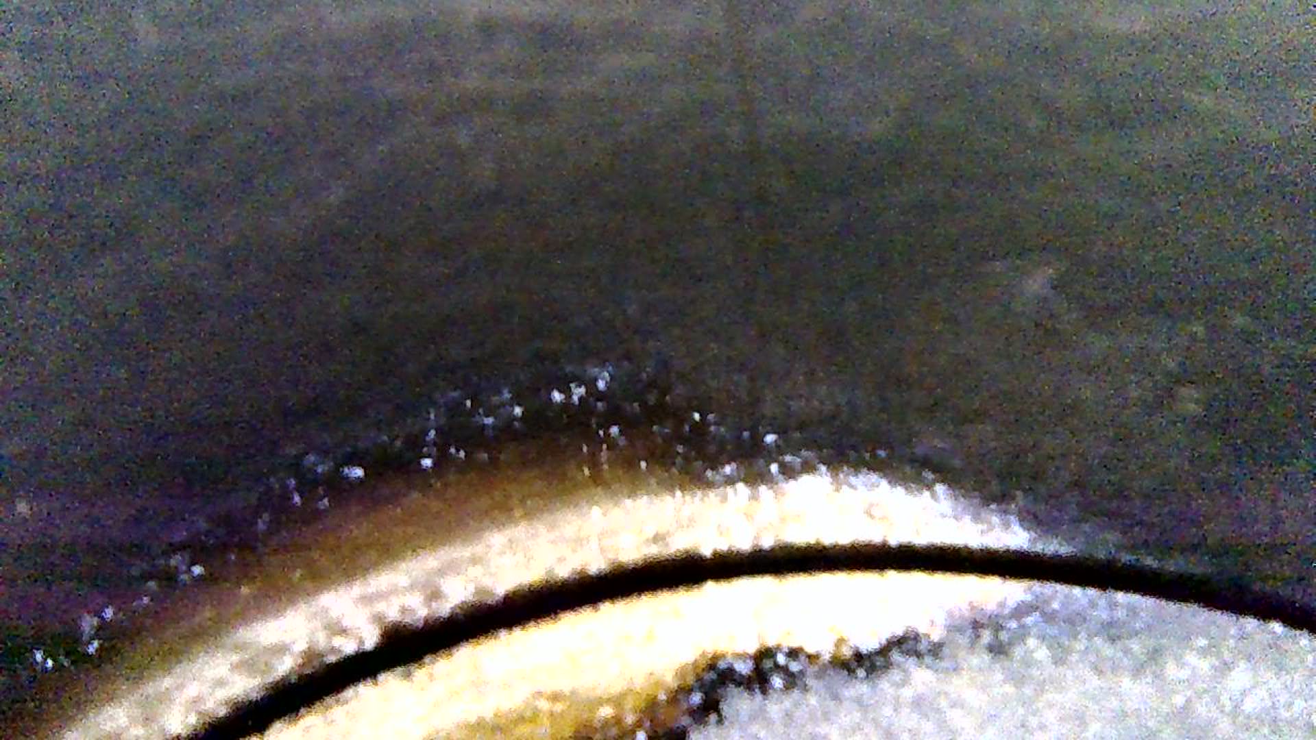

    The cylinder walls are suspect in places. Here's one place I think I see a vertical line and maybe some ridging.​

    • KiwiAlfa156
      • 661
      • New Zealand
      Hi Seinwave
      My two cents is that you want to be 100% certain of the source of the oil leaks. Disturbing good joints that aren't leaking can lead to that joint leaking. Including if you aren't fastidious in your gasket replacement. The likelihood that it the leak has just started, its coming from the last thing you disturbed. Note, oil leaking and oil weeping are to my mind different. Once outside the engine, gravity (and wind while riding) will move oil around. So oil around the base of the barrels doesn't automatically indicate that this is the source.
      A head gasket oil leak (if you have one) isn't an indication of the condition of your rings. Smoke is oil being burnt in your engine, i.e. poor oil control. Leaked oil is outside your engine so isn't likely to be related. Oil under pressure only passed though the head gasket on the 4 outer head studs which use the barrel stud holes as oil galleries. So leaks happen in these areas. If you get oil weeping at other areas around the head gasket it is likely capillary action between the gasket and the mating surface after 40 years of heat cycling.
      If smoke, and excessive oil consumption (probably?) is the issue you wish to address, then pulling it apart and inspecting it and repair is the solution. The oil leaks should be dealt with by careful reassembly.
      I did my Katana 650, a few years ago. https://www.thegsresources.com/_foru...ild-historical
      Your plan looks good. If it were me, I'd do everything, to ALL cylinders while its apart. because this you opportunity to do all of it. There's not advantage in doing 2 cylinders only. That's doing half the job.
      Ring/hone, valves lapped (by hand NOT by using an electric drill) and fresh stem seals (you have to remove the valve spring to lap the valves anyway), clean the pistons, you have to have clean grooves for the new rings, wrist pins are unlikely to be worn, so just new clips. Measure the piston/cylinder, ring/land clearances, set the ring end gap. Don't forget the barrel o'rings. Personally I'd get the head and barrels refaced at a machine shop to ensure that the new head gasket get the best possible life. Make sure that all mating surfaces are grease and oil free before putting on gaskets.

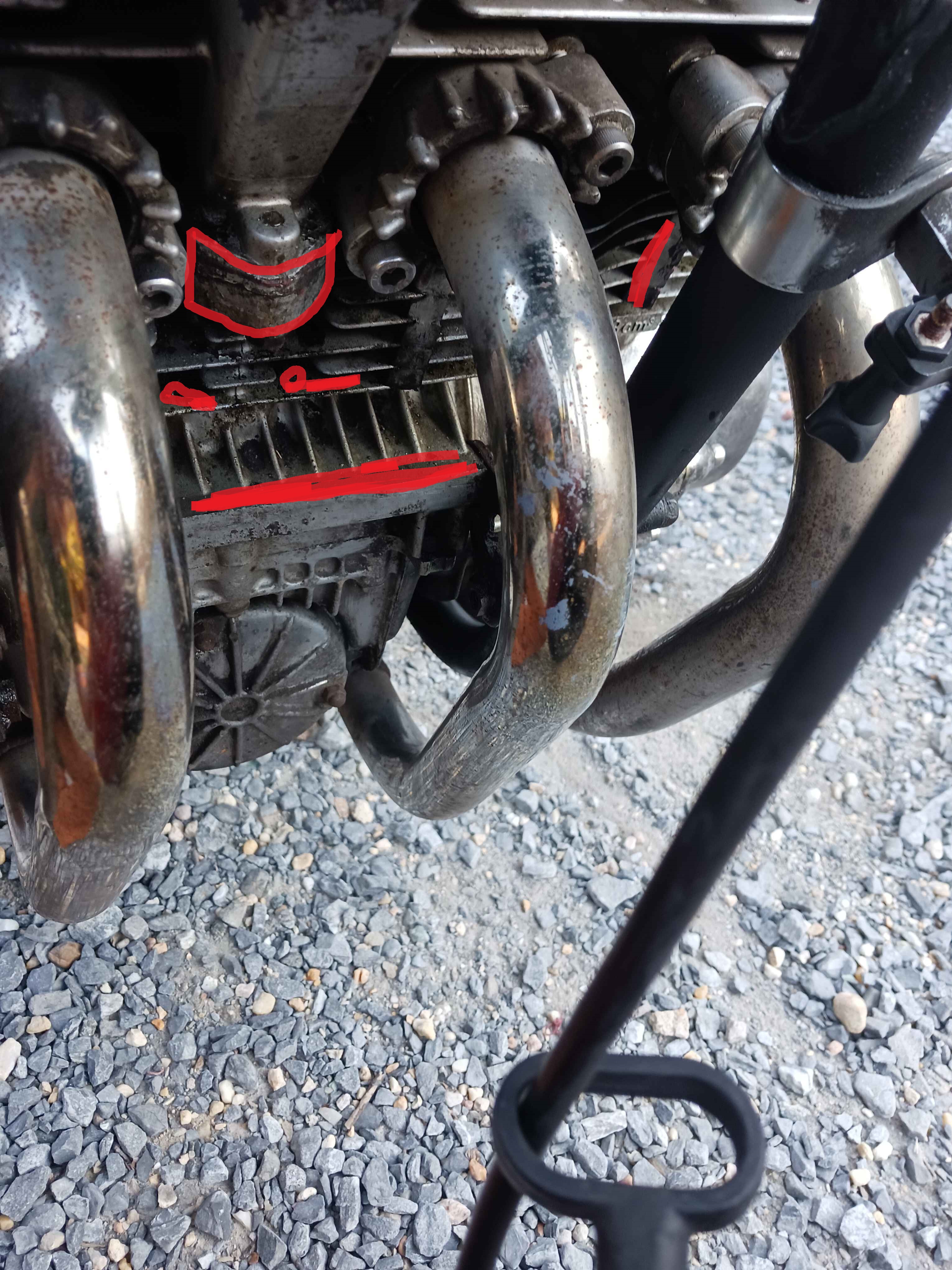

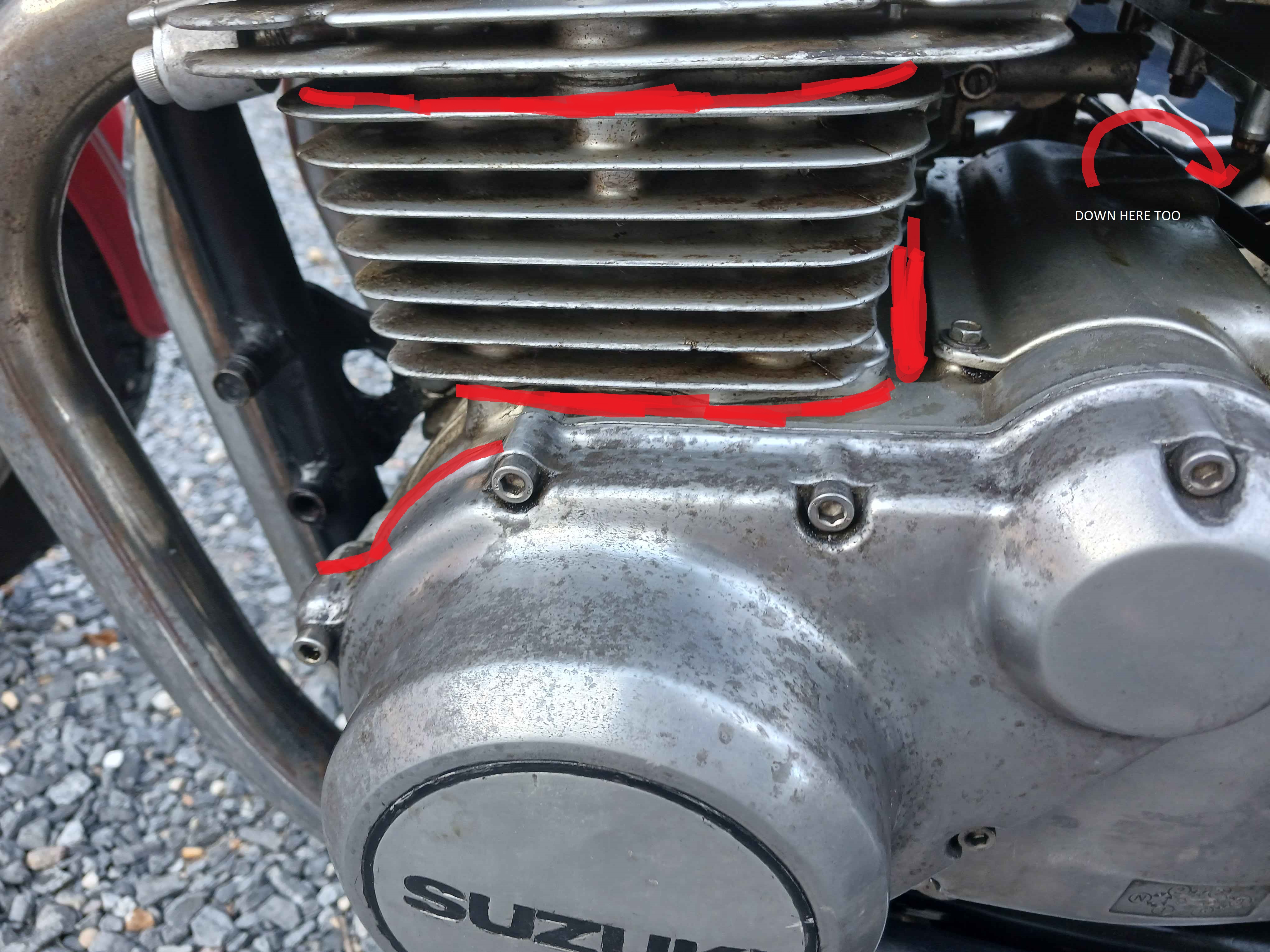

                May be some photos of where the oil is leaking? Also if the 6 mm to cam cover bolt holes are stripped, the correct (best and permanent) fix is to use a thread insert. You do need all of these bolts torqued evenly to the correct torque for the gasket to work as intended.

                  I can certainly show you where I saw oil on the engine during and after my diagnostic rides....
                  (these aren't up to date - think this was before I zeroed in on the gaskets as an issue, but after I'd cleaned the engine up a little, but before I cleaned it up properly. So if you see oil, it's not necessarily where the current suspected leaks are, and if you see gunk or any other signs of poor maintenance - it definitely isn't there any more and it's also from the previous owner and also no you didn't and uh...)
                  ...but that won't really answer the question of where that oil came from. Guess I'll have to go on another little ride - oh no!
                  (also while I'd love it to be the CCT gasket - careful observation seems to have ruled that out.)

                    One piston top looks eroded possibly preignition?
                    the oil will stop leaking when you replace the gaskets.

                      I'm now realizing one of my edits ate an important part of my original post. Yes, I saw some evidence of detonation (I assume you're talking about cylinder 1?) - there's one or two small circular divots (seems to mostly be in the carbon layer?) that absolutely refused to show up on camera.

                        Nothing looks to out of the ordinary. Just standard carbon build up. If the Bike was run with a poorly tuned/cleaned carb you can get carbon build up from running rich. The piston edges and walls look fine. Your valve stem gaskets are probably hard and letting oil suck in on decel, it's a pretty common issue. You can change the valve stem gaskets without pulling the motor apart. If you are feeling froggy run a little marvin mystery oil in your oil to help clean up piston rings and oil rings.
                        If you are just looking at getting it operational, then i would rebuild the carbs, replace the intake boots and o-rings and give the motor a good pressure wash, it's pretty crudy so it's hard to tell where all the oil is coming from.
                        Then run the bike for a while, beat on it and give her some rpms and then do another scope and see what it looks like.
                        If you are hell bent on doing gaskets, plan for base and head gaskets and take the cylinder and head to a machine shop to have them fly cut the head surfaces for a perfect sealing surface. A lot of times DYI folks do a poor job cleaning surfaces or use the wrong tools cleaning surfaces and make things worst.

                            It actually runs fine and has given me about 4,200 miles of service in the last year - it just leaks. A little bit after my last post, I did conclusively figure out that the oil I was seeing was from some sneaky valve cover leaks, not bad gaskets. Not that that means the gaskets are good to go! They're just not leaking, seeping, or wicking *yet*.
                            I rebuilt the carbs about a year ago, and the boots are still supple. It was definitely running pig-rich on idle for a while - I had the idle mixture screws so rich I could smell it at longer stops, but didn't get around to leaning it down for a while. The fact that it's in 1 and 4 way more than 2 and 3 makes me think I need to properly sync them again. I also had a long storied saga with a flabby ignition system that finally died, so I wonder if some of that carbon is from bad timing and/or weak spark for a while.
                            The valve stems are definitely hardened up. Or, at least, I'd be shocked if they weren't, given the nature of its morning smoking habit.
                            Do you think the average machine shop will understand what I mean if I ask them to fly cut the head and block? *I* know what you mean, but I am not confident enough in my mechanical knowledge to say whether they will. If not, what are some key words or descriptions I could give them over the phone so I know we're speaking the same language?
                            I already snagged a couple key items (the head gasket in particular) a few months ago, and this time I've ordered all the parts I think I'll need.
                            I did decide to get a good quality used cylinder head and build it on the bench, versus attempting to rebuild and rethread my current head all at once. Comparing about $120 shipped and several hours of work just for the rethreading vs. $175 shipped for a head that I *think* is in ready-to-rebuild condition made me see the latter as the better move. This way, I'll have one freshly-rebuilt head and one reserve head to play around with or call upon in case of disaster, versus one head that I'll be crossing myself over every time I bolt or unbolt something. Also, I can take my time to do the bulk of the work properly and slowwwwwly instead of under pressure as my engine sits open-topped and vulnerable.
