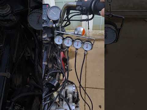

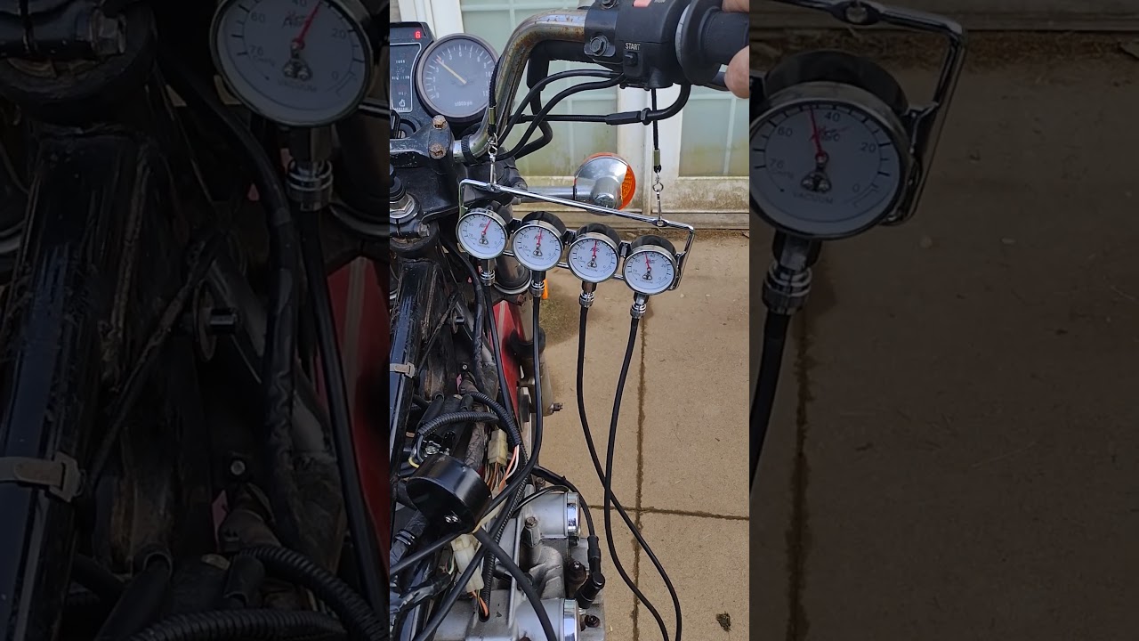

            My guess after watching your video, one of the carb slides is hangin in the wide open position after you rev it up and build lots of vacuum, then you back down the engine speed and the slide doesn't drop to match vacuum causing a rich condition. But without you answering the questions above it's anyone guess. I assume all your slides have springs to return them to the bottom position when there is no vacuum?
              Correct. When I ran it without the intake boots on, the slides do stay up while it is bogging and the RPMs drop. I confirmed that they are the correct diaphragm springs. I even added spacers on top of the slide to increase spring pressure and that made no difference.

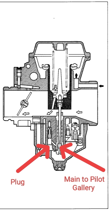

                The rubber plugs over the pilot jets in the Mikuni BS are important. With the plugs in place the pilot draws fuel though the main jet (i.e all fuel entering the engine -apart from the choke circuit- passes through the main jet first). With out the plugs when the throttle is opened up fuel to the main circuit can by-pass the main jet as it flows past where the plug should be, reverses back down the gallery that connects the main to pilot, and whole shooting match runs super rich. I know this from experience when I forgot to install the plugs (duh) and the bike would run perfectly on low throttle opening as and then not go over about 5,000 rpm winding on to WFO throttle. Plug chop in that condition and plugs were sooty.

                    K&L makes rebuild kits that come with fresh rubber plugs. If the old plugs don't stay seated when installed time for new ones.

                      This is the first worthwhile lead I've had on this in over a year and would explain everything. I don't remember the kits having any plugs in them, but it is very possible I just didn't know what they were for. It didn't have plugs in it when I got the bike so I just assumed that was normal. Both carb racks are exactly the same (without the plugs).
                      I just ordered 2 sets of plugs (K&L 13357-44080) from eBay for both carb racks.
                      Just confirming, the plug goes here?

                        Well, I think you've got the answer... Explains why ran better with air filter removed. Hoping you haven't got other things too bad out of adjustment trying to get this figured. Don't forget we need updates as you continue. ... Sorry, it seems we were thinking too much about the bike and forgot the WELCOME ABOARD you should have got. Glad you found us.

                          Yes, if you look at the float bowl, there is a matching nub on the bowl that presses against the plug to help hold it in.

                            Yup, that the space where the plug goes.
