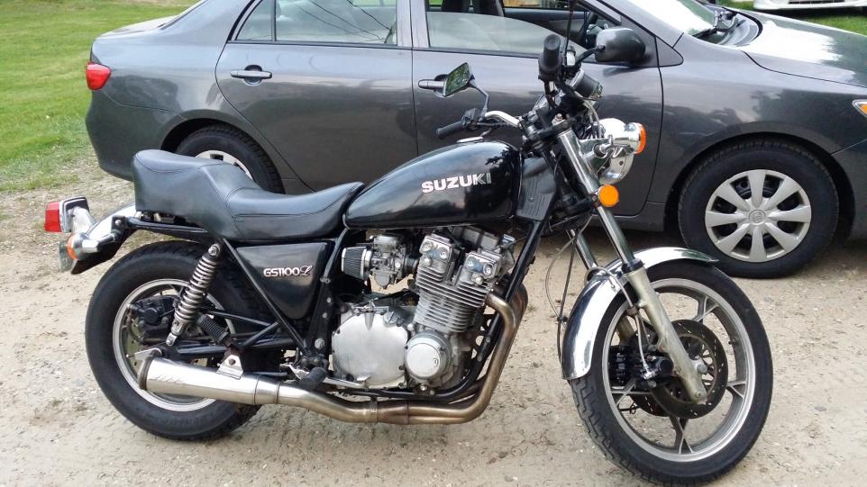

                              Pic of my project 1980 GS1100LT
                              The pic looks A LOT better than the bike looks...
