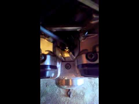

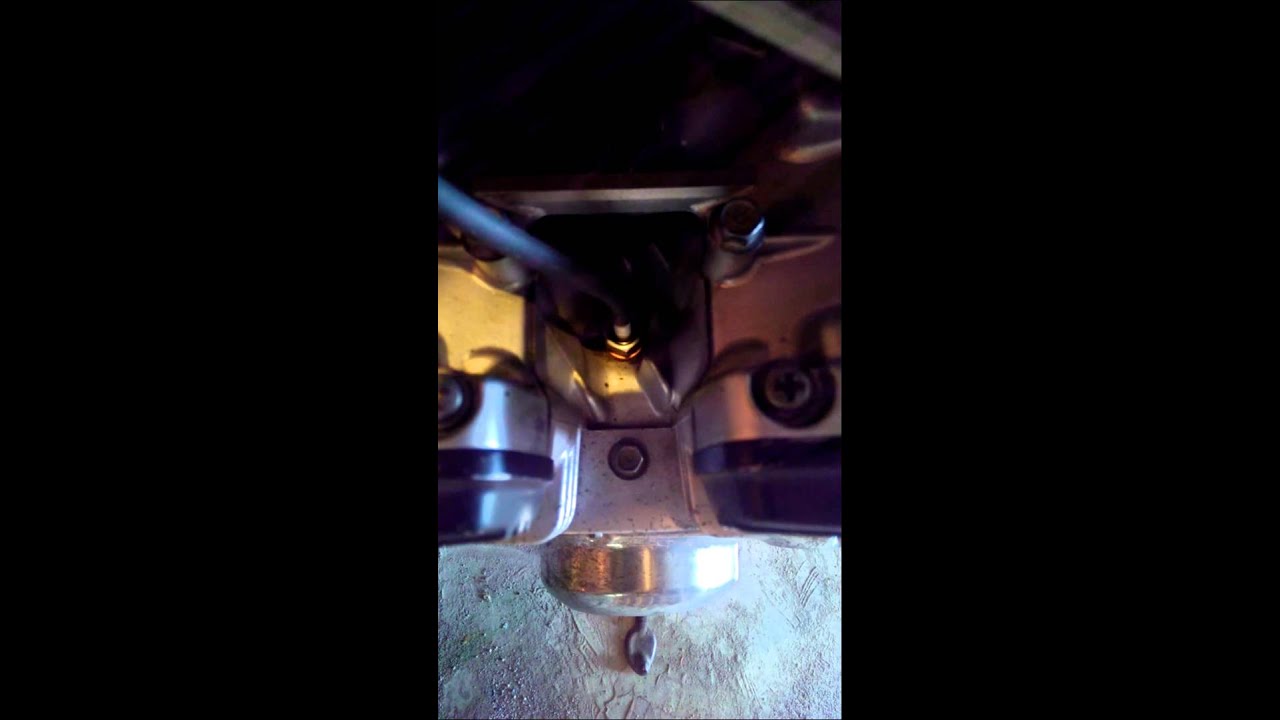

    After sorting out some issues with this bike I got some riding in but it was running poorly. It stumbled into low throttle, and didn't idle well. Also the top speed was pitifully low. I decided to clean the carbs and install the stage 3 dynojet kit, since I'm using the APE air filters and the Jardine exhaust that came with the bike. I got them apart, and saw there was already a stage 3 kit using the larger jets and the needle clip in the 3rd slot from the top. Moving UP, there was the spring, a large washer, smaller washer, clip (3rd notch from the top), then the spacer. I put everything back together as it was after dipping, spraying, bench syncing the carbs. I also setup the float heights using a digital caliper (they were WAY off). Used all new o-rings from cycleorings.com. I set the idle screw 2.5 turns out, then 3 turns out, then 3.5 turns out. I'm still not sure if this is rich enough. I'm also at ~4280ft (1519m) elevation.
    Now the confusion: The engine starts cold without the choke which would lead me to believe it is running rich, except that when I give it some throttle it sputters, then falls slowly back to idle (lean, right?). I have the idle at around 1100.
    for your viewing pleasure, with the colortune, after ~3 minutes of runtime:

            The Color Tune is notoriously inaccurate when used with CV carbs. Look up "fast idle method" to adjust the mixture screws. From the sound of it, it sounds like it's not running on all four cylinders. Check to see if any of the pipes are colder then the rest.

              whats with the arcing plug? isn't that the problem?
                That's the Color Tune system. Shows you what the combustion color is.
