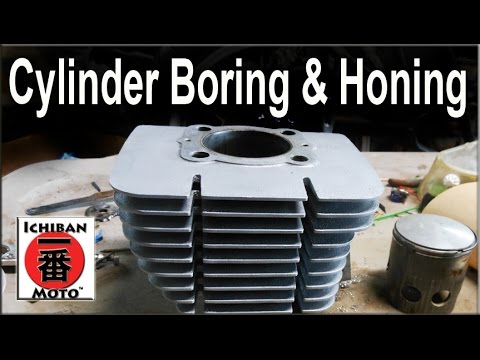

                so, the funny thing here is that this vid was my suggestion to ichiban and earned me 5 out of 5 ichiban moto stickers! BADASS.
                • loud et
                  So THATS why he said Greg in the video. Haha. I thought it was just coincidence when Ed posted it.
