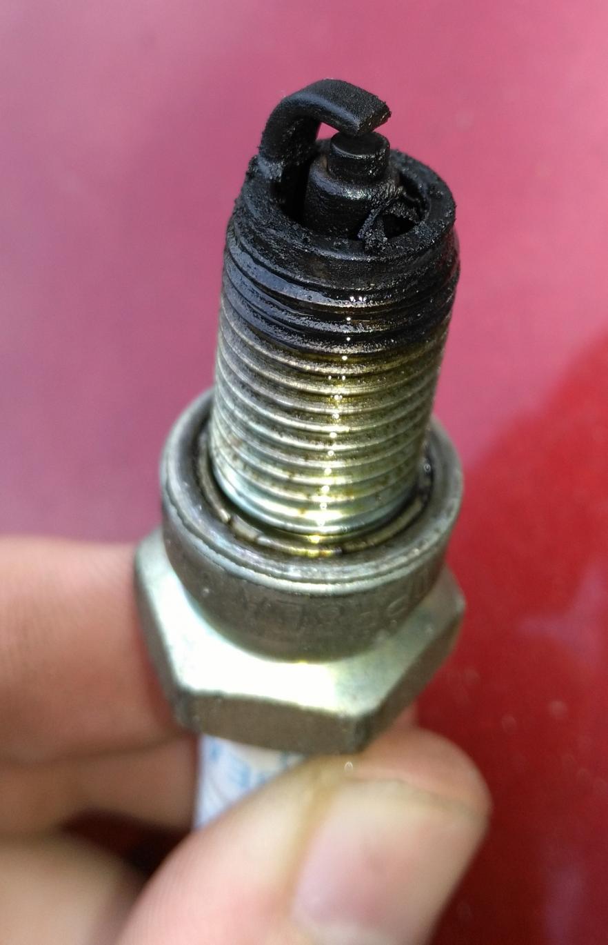

    Am I correct in assuming that my valves are not leaky? This looks to me like a piston issue. Next the spark plugs:
    1 -
    2 -
    3 -
    4 -
    Yes, there was actual gunk on sparkplug 1... The oil is being burned in the left exhaust (clearly visible while driving). So 1 and/or 2 are burning oil noticeably.
    Gee, what should I do with this one? Looks to me it is in pretty rough shape...

    Compression is supposed to be measured with the engine hot in order to get any meaningful numbers. However, for a cold engine, those readings are not out of the ordinary.
    The burning oil and fouled plugs are probably symptoms of the bike's history of being ridden for a few minutes and then put away. These engines were designed to be run at reasonably high RPMs for extended periods of time. Put on a helmet, find some back roads, and cruise for an hour or two. Let it run. Don't be afraid to whack open the throttle from time to time.

      What he said, plus look at the petcock. #2 looks rich, not oil fouled. #2 is the one with the vacuum port going to the petcock. Coincidence? Probably not. I would suspect a leaky diaphragm in the petcock.
      I'd also do as eli suggests, except I'd do it on a big motorway, run the heck out of it for an hour or two. Or ten. Might help, might not.
      The last two spark plug pics look fine, except they look a lot richer than plugs usually do from a stock 650G, which are usually almost white. Not that some color on the plugs is bad, but I'm thinking maybe something is going on inside the carbs, or maybe someone rejetted it richer for some reason.
