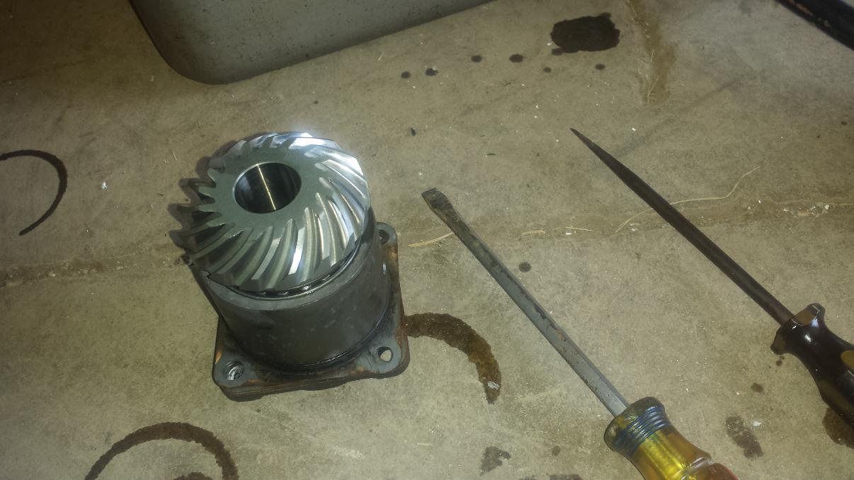

I tore into the drive gear assembly today. After I removed it I started the bike and ran it through all 5 gears, no noise
. But...when I looked into the cavity I saw something interesting. I'll post pictures but gorminrider I think you hit it on that last post.
The driven gear was able to slide out to the drive gear shaft and expose the roller bearings. I could slide it back and forth and flop it around.
Somehow (loose nut, stripped thread?) I lost the pre-load on the driven assembly. But the drive assembly looks good.Attached FilesAlan
