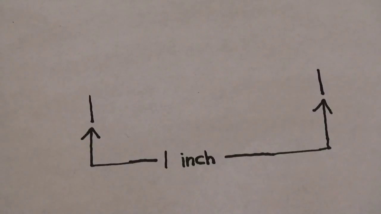

    how do I tell the difference in the 530/630
    I am combining the 1983s and maintaining the 81
    year / model / teeth on rear sprocket
    1983 750E T50
    1983 750ES T43 - says 530/43 so I'm guessing it has a 530 chain
    1981 750L T40
    The E has the largest diameter
    The ES has a smaller diameter than the E
    The L is between the E and the ES
    The L is only slightly smaller than the E which surprise me since it counts 10 teeth less.

      that is a great video. got the logic
      now how do I tell if I have O rings or not?

        If you can see the o-rings, that's what you have.

          VERY! helpful, thanks!
          I have 630 on the 81 L and it is an Oring
          530 on the 83 E and ES, one oring , one not
