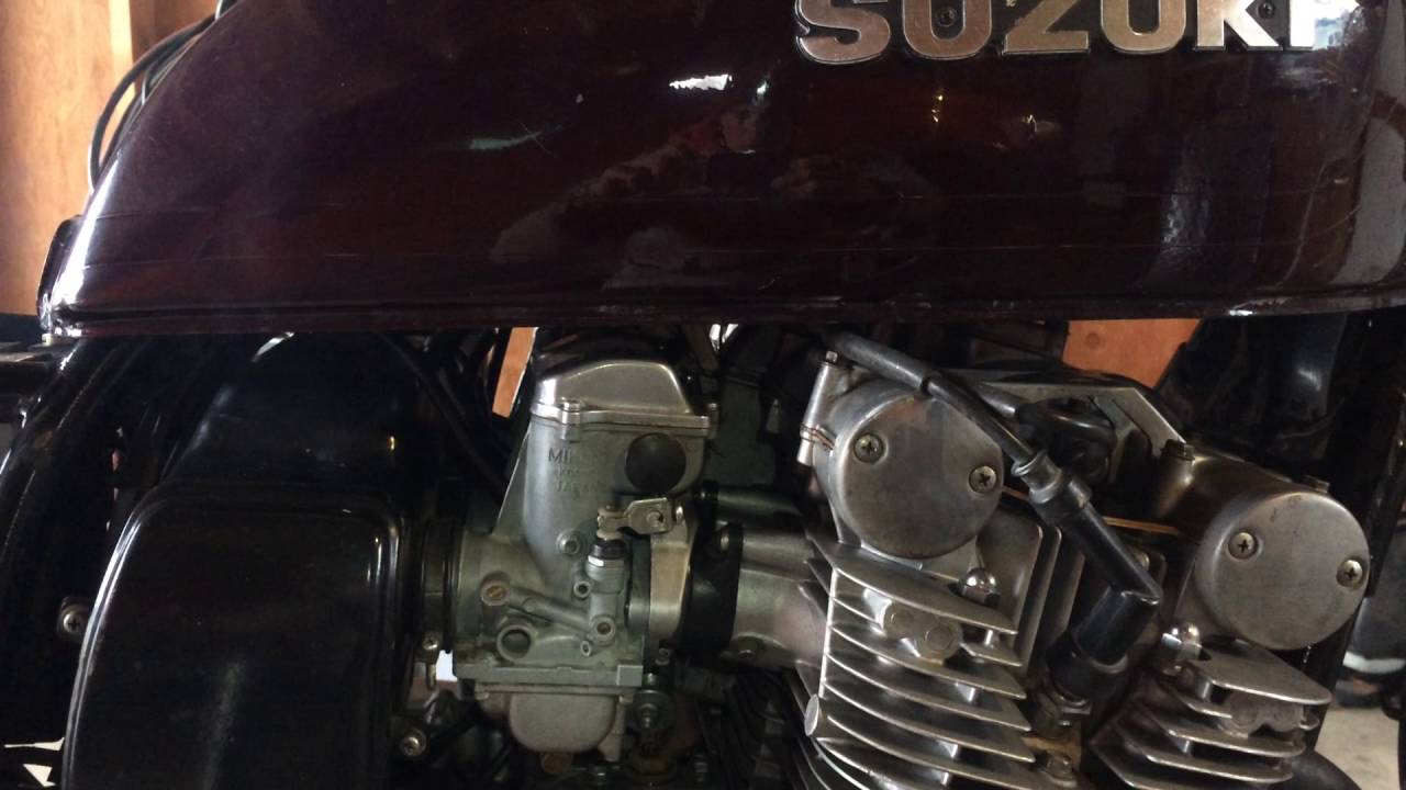

                            • ehkmcveh
                              Just tapped a piece of paper to the base of the bike, to capture where the oil leak is coming from the bike.... it doesn't look that bad so its not the oil pan causing the smoking.
                              Just had the bike started up, when it got warm it appears the smoke is coming out of the head gasket. Not really sure what that means... it doesn't smell like exhaust... almost plastic like?
                              I hope there is not engine damage occurring
                              • ehkmcveh
                                #30
                                Here is a ruff video of the smoke at lower speeds.
